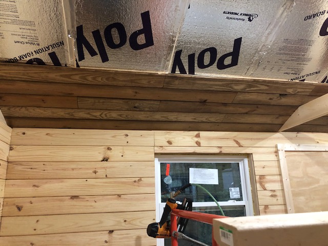

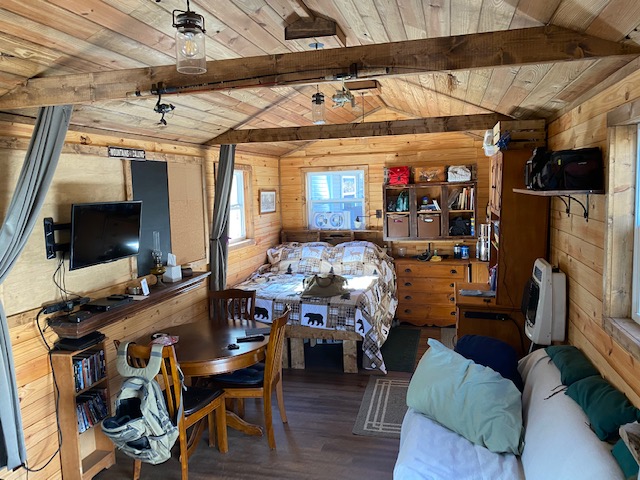

I will say that T&G is the best to do if doing by yourself and is pretty easy if you use an air nailer, Ship lap is a pain by yourself- that is what id id on the walls and said heck with that and used T&G on the ceiling.
If you have a Craiglist type site in your area check for it on there. We have a supply place that puts bundles of #2 pine T&G up for a good price. It will have some cracks and knot holes to cut out, but is fine for DIY and you are not rushing- it would make a pro mad because of the time waste, lol
First photo is after I had on walls and started on roof.
Second is with all our crap in it lol

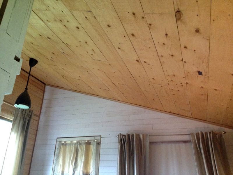

I did the ceiling of my cabin with 8" wide plywood strips ripped on a table saw (3/8" thick). Gave them a coat of varathane before attaching and am pretty happy with the results. I'd probably advise against it for wall panelling, but I don't mind the look at all for a ceiling. At the time a few years ago it worked out to around 65cents a square foot, hard to beat.

# Posted: 3 May 2022 07:37pm
That does look good in the pic, as you say, for a ceiling. Were they cut on a sheet goods saw jig?
# Posted: 3 May 2022 09:01pm
That is not what immediately comes to mind when someone mentions ripping plywood to look like boards.
In a ceiling application, the height distance may make it more difficult to discern that it is plywood.
That does look good. Not what I would expect
