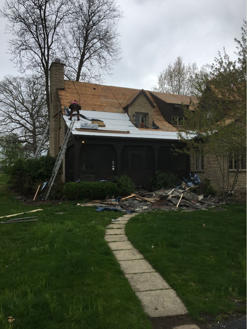

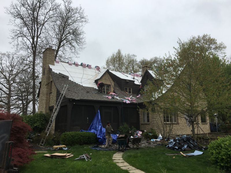

Tim_Ohio
# Posted: 9 May 2022 10:11am - Edited by: Tim_Ohio
We just re-roofed a 1936 house. We did not know it, but the asphalt shingles that were to be replaced were installed over top of the original slated. There was only one layer. We think since 1936, it had only two roofs on it, the slate, then the asphalt. The roofers said it was the most difficult removal they had ever done. They used a white under-layment. I'd never seen this type before. It rolled out like felt, but had a backing that was removed as it was applied. I'm thinking it had an adhesive backing. I received the pics from my wife. It's hard to tell what brand they used. I'm thinking it was high quality stuff, since this job cost us 20K. It was to be warranted for our lifetime and transferable to any new owner once. In other words, we paid extra for the roof to be replace if it ever failed in our lifetime.
roof 1
roof 1
roof 2
roof 2
# Posted: 9 May 2022 10:57am
Tim that's just ice and water shield. With the way your roof is shaped it's almost mandatory that they use ice and water shield on it. Lots of dormer and valley angles in that roof.

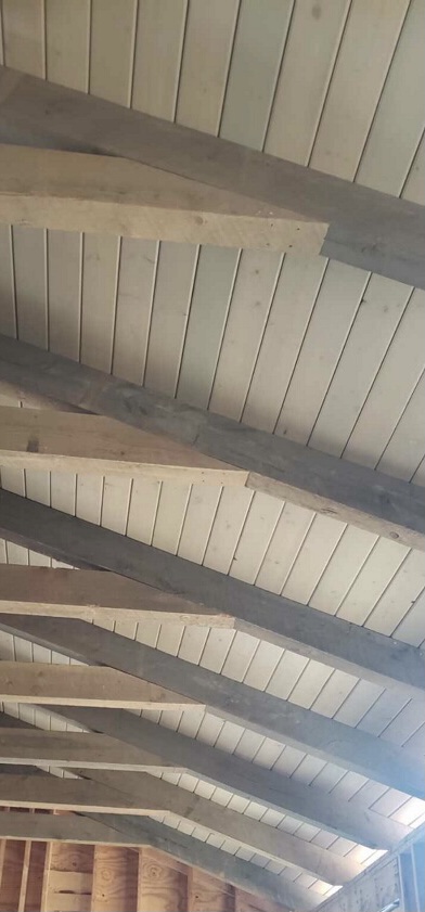

Riv
# Posted: 10 May 2022 07:01am
Thanks everyone!! You are just confirming what I thought.
FYI - this is the way the roof will look from the inside. He wants to put foam board on top and then shingles.
jsahara24
# Posted: 10 May 2022 09:09am
That's a very nice look!
1" of foamboard doesn't sound like enough insulation though...May want to look into that when considering snow/ice shield, venting and condensation concerns....
Good luck
# Posted: 10 May 2022 09:17am
Depending on your winters you might want more.
Styro atop the ceiling boards is not uncommon and there are accepted and approved methods to do so.
Your builder may need some education but likely can do it right once he knows how.
Tim_Ohio
# Posted: 10 May 2022 09:25am
Based on my images, where the roofer uses the snow and ice shield, then the shingles are installed, I'd think putting the snow and ice shield on first, would be a good idea. Then, add the foam board and finally the shingles. Then, the snow and ice shield will reduce the possible leaks. It's a difficult call when you want a ceiling to look that way. It looks nice, but it's not ideal since it's not easy to insulate. The ceiling, as you know, is where you will have the most heat loss. I always liked that look, too. It's just a difficult one to deal with.
