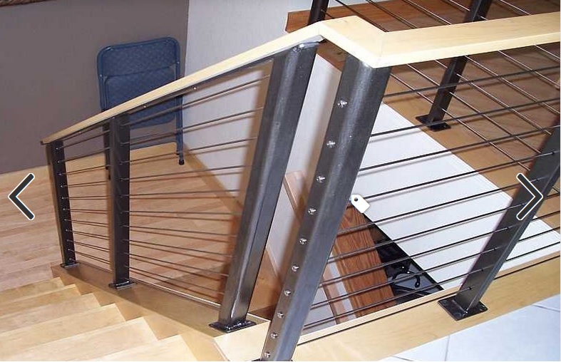

I decided on something like this.
Its pretty affordable if you go %100 DIY. However, not everyone has the tools and know how to weld up the balusters. Even then, they sell premade balusters that are NOT SUPER expensive. The stainless cable, ends and crimper are surprisingly cheap.
Its definitely a quick way to get up a railing. Its pretty much a one man day job for around stairs like your pic (using premade stuff).
If you do have the tools and know how... Then it gives you something to do in the evenings after work (when you can't get out to the cabin).

Quoting: travellerw
My only caution on this method - is if you have little ones (anyone under about 10), as this might as well be a ladder baited with candy. Not sure what the attraction is, but keeping kids from climbing the horizontal "rungs" is basically a fulltime job..
If there's no kiddos around, no worries - I think it will look great!

Since i recently bought a welder, i was leaning towards the hog fence idea, but i'm liking this idea more for a simpler install. Do you have any links to the crimper/ends that your using? Are you leaving your cable natural stainless color or painting it somehow?
I bought everything on Amazon (Crimper, ends, cable). I will see if I can find links to it so you have an example.
I will be painting all the balusters black (might get them powder coated if its not too expensive). I will leave all the cable shiny stainless as I look the look of stainless on black.
I'm trying to figure out what to do with the top rail now. The cost of even paint grade wood is crazy high and that top rail will be like %75 the cost of all the other components.. Sigh.

Just a word of warning.. Some local codes don't allow horizontal members in railings. Check with your codes to make sure its OK. Our local code was recently changed to allow it.
