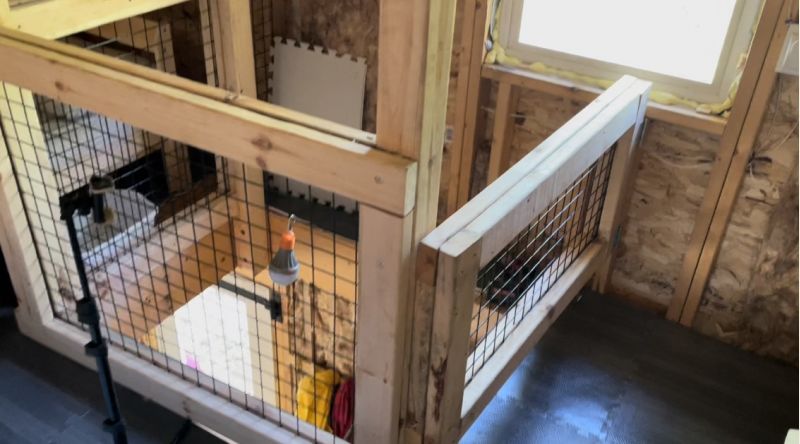

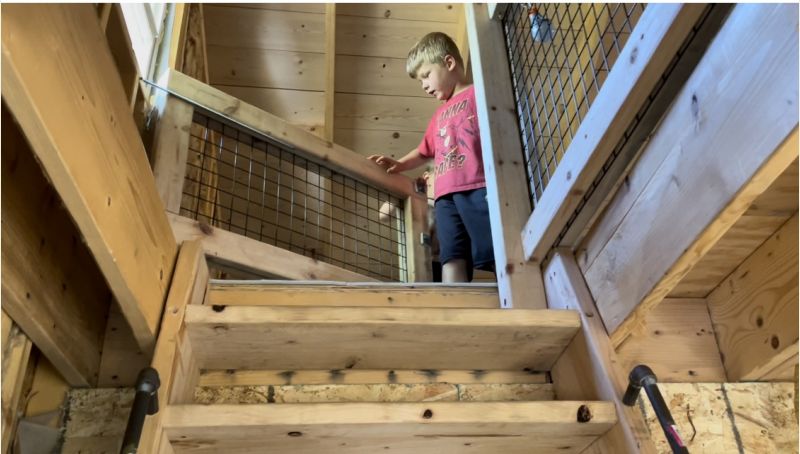

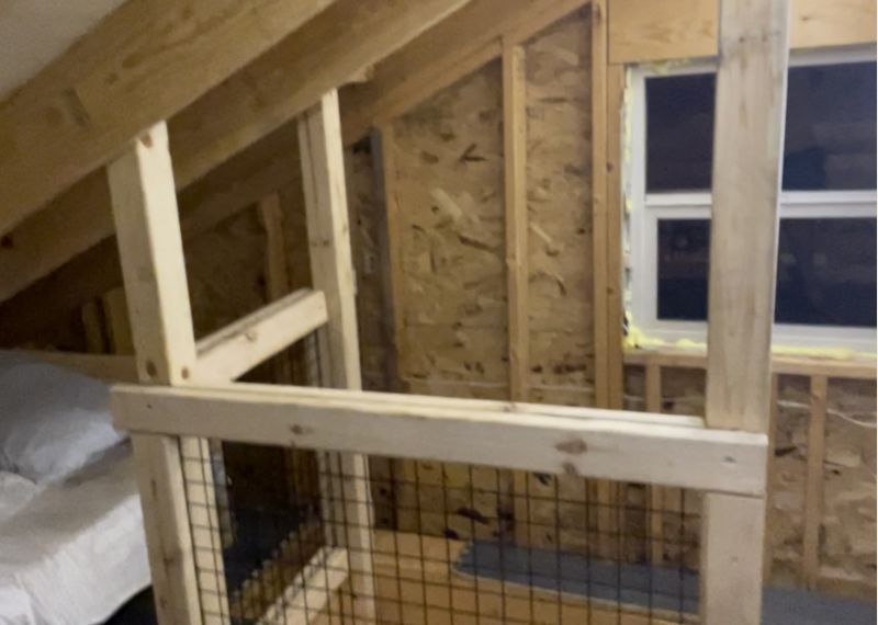

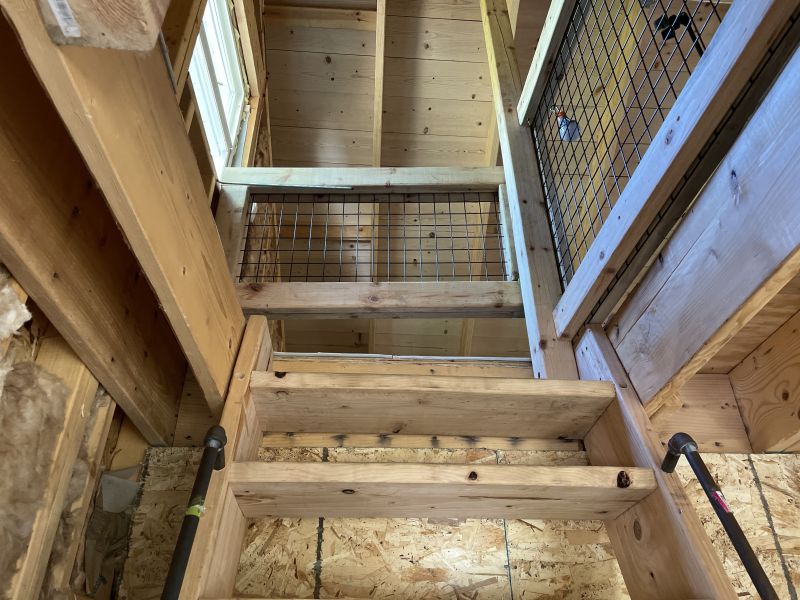

Hi all- looking for suggestions.
We have a loft that is accessed through a hole in the floor and a steep stairs/ ladder. It rises 9 ft in a 4 ft space.
The hole in the floor is 3x4 and surrounded on 3 sides by railings- however the ladder opening side is not.
3 kids sleeping in loft- 8,5, and 4.
I need to put a gate of some sort on the open side.
What concerns me is if someone accidentally steps back off the loft it’s a straight fall down 9 ft… with some tumbling and bumping on the ladder…
Anyone done something similar with a gate of some sort? Or any other inventive solutions?
One consideration to keep in mind is that if the gate makes it harder to get into the loft that’s a problem as well as it means kids finagling with it on the ladder just to get in….
Sorry no great photos- this is the best I have and are from last year.
Thanks in advance!

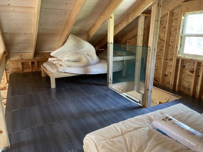

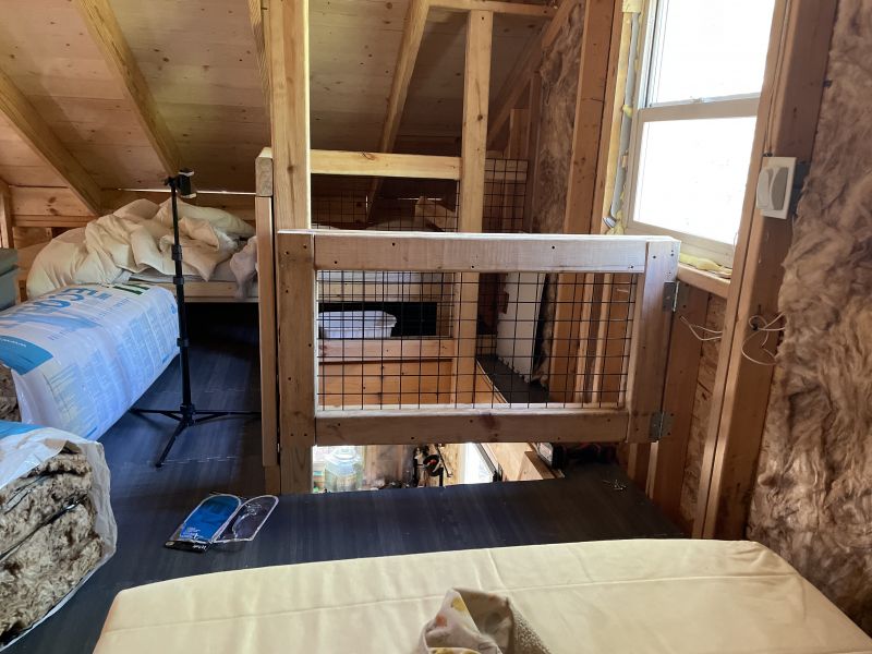

# Posted: 5 Jun 2022 10:58pm
To put a cap on this. I built a 2x4 frame that sandwiches welded wire matching the rest of the railing. I simply used a patio door spring. It’s very loose so it barely takes any force to open and closes gently . Door is sort of heavy but opens easily on hinges and closes slowly. Works great.

# Posted: 10 Jun 2022 08:27am
That's just what you needed, slight pressure when entering and no slap in the rear when exiting.
Real KISS tech.
