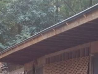

Here are some nice rustic looking gutters:
https://ritewayguttersroseburg.com/wood-gutters-roseburg.html
Might be able to make your own out of rot restraint wood.

I had thought about making a troff like gutter. It looks cool, but sounds like a lot of work
i like paulz's idea, some cut up PVC pipe. But I like the square look better, I think I've seen square plastic PVC type thing at our local hardware store. I think its for finishing or capping posts. That might work
