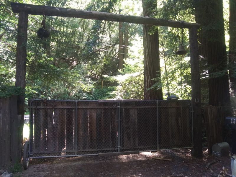

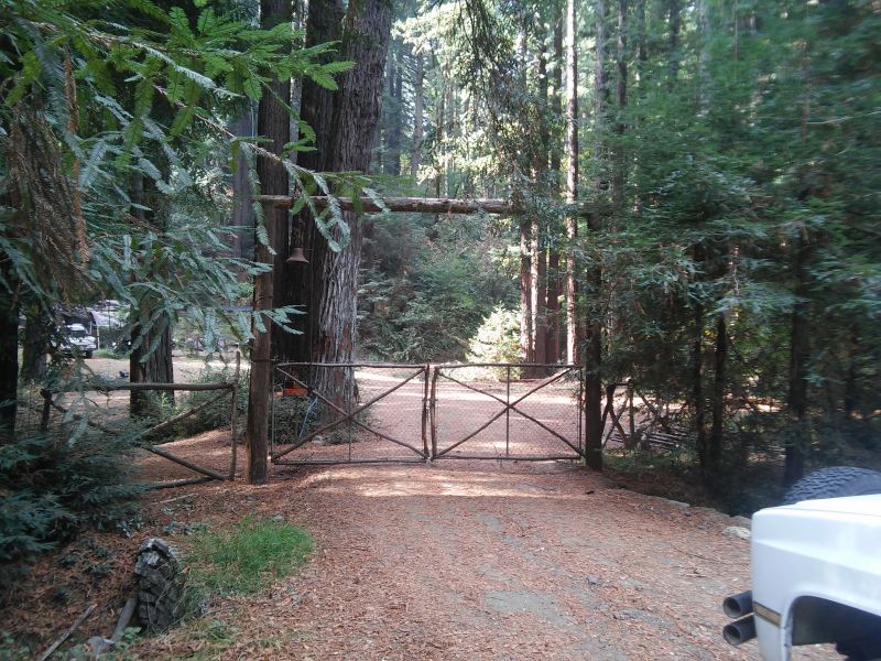

My ever evolving cheap gate has gone through several changes.
My place came with double chain link gates, albeit fallen over in the bushes. Might as well use 'em, so I did, and wired some sticks around the piping to hide it. Attached it to some logs I made an overhead support for.
The I decided I wanted an electric opener, so I got one and bolted both gates together into one. I used it for awhile but had to keep a battery out there, plus I like to chain lock it anyway, so took the opener off.
Then when I started having a lot of junk sitting around the yard, I put some old fence boards over it, and that's how it is now. Plus there is a motorcycle wheel helping hold up the end.
Not high class, but actually goes pretty well with the rustic fencing in the area. Some day I'll do a nice gate from scratch..

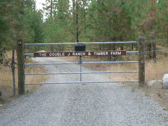

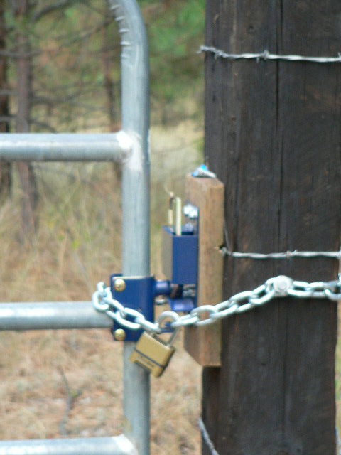

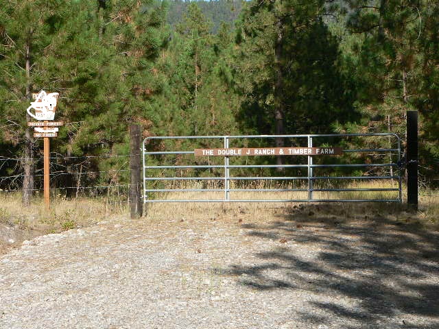

I use a common metal 5 rail gate, get a 16 footer, no exceptions. Attach your gate to a cemented in good railroad tie, then get a Spearco gate latch and then sink final railroad tie for latch end. The Spearco allows the gate to open in or out, carry s weight of person standing on gate. I do wrap a chain around post and gate (3/8" stainless chain) and have it bolted to gate so when its opened, the chain stays in place. Do both ends, so they cant steal the gate. My padlocks are the American A700 series with 7/16 hasp all keyed alike.
Gate hinge goes in inside of rail road tie, if you go on front or back, will open fully in only one direction. So keep hinge on inside.
Spearco 2 way gate latch
16 foot 5 rail gate
If you get lots of snow and plan on opening it then, set it up higher

Quoting: toyota_mdt_tech
That latch is pretty sweet! I have been wondering about good latch mechanisms so I will look into this!

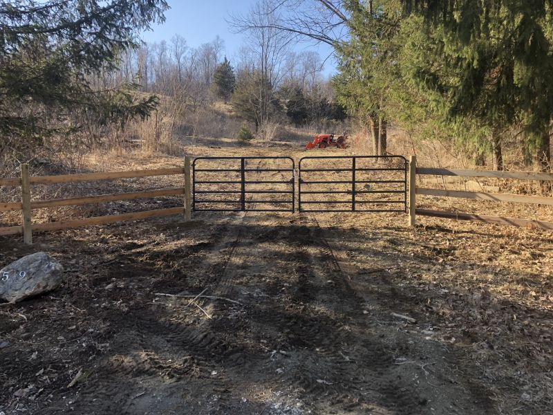

I am thinking I can weld the gate myself as I have access to cheap metal remnants often via our metal dumpster at work.

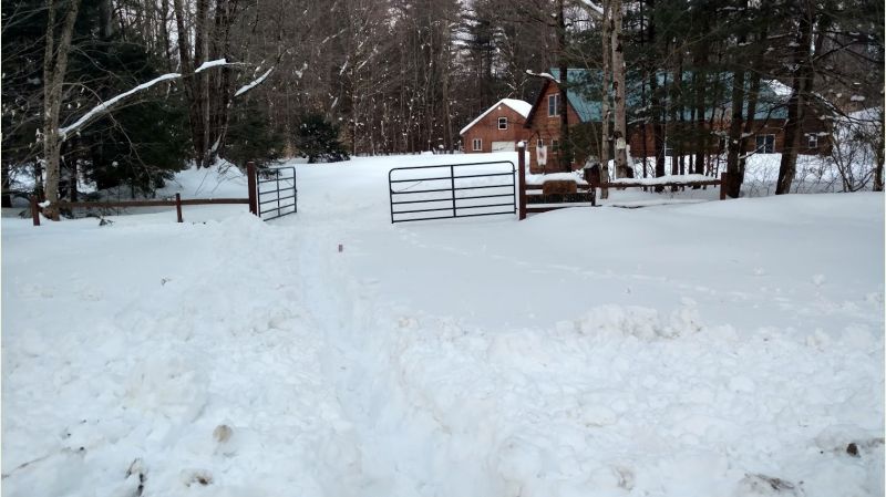

Photo attached of the current gate at my borrowed driveway. It works well enough to get the point across and deter the average person poking about.. I was thinking of something like this, but maybe only a single wider swing gate? I understand that would require more robust hinges though.

Geez you drive earth moving equipment through there?
Agree with TMT though, 16 footer at least. I have a pretty tight turn off the main road, and with a long trailer to get through all the width helps.
BRADISH
# Posted: 8 Jun 2022 04:16pm
Technically yes - I bring my bobcat through there all the time!
But the photo may be deceiving, the top rail of that gate is probably 4ft off the ground (when snow is gone) and its probably 20ft between gate posts.
I wouldn't do anything less than 16ft.
I have access to 8" pipe i could set down 8ft as a solid post if I do a single swing arm. Or I could do two swing arms and go with 4.5" pipe that I already have on site.

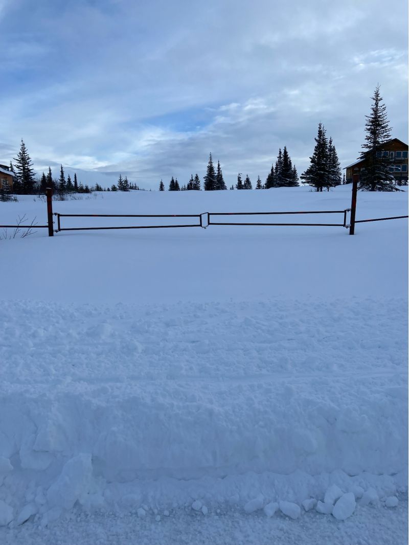

Do you have any trouble with clearance for the cattle gate over the snow? How high do you have it set above grade?
jsahara24
# Posted: 8 Jun 2022 04:37pm
Yes, we are in the lake ontario snow belt, lots of lake effect...we set the bottom of the gate about 2.5' above the ground and that has worked pretty well....
The snow has gone above it, but our snow is light and fluffy and you can open the gate through it without much issue....I'm not sure what kind of snow you guys get in AK but if its wet/heavy you could have some trouble.....
A normal winter puts us at about a 3' deep snowpack, with an average of >200" per year.....but we tend to get some thaws to keep it from building up too deep....

Notice on that Speer latch, the part that bolts to the gate, the thru bolt is just under a rail, this keeps it from sliding if someone was to step on the gate to climb over it.
That lock on there is replaced with the American 700 series
