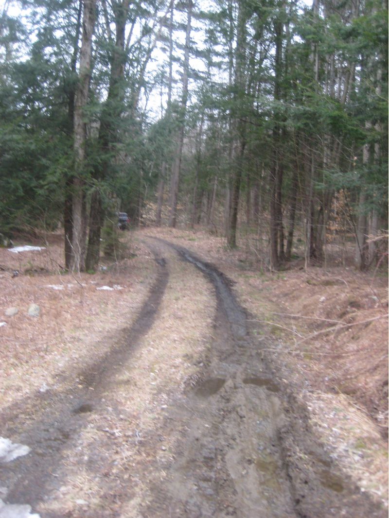

Here's a picture below of the describes spot. Since the picture was taken, the right side of the pic has become more soggy/ wet. Thanks for the ideas everyone.

I am not sure the best way to "bridge" that area, but you can make the most of dry weather by draining all standing water -- either fill in the area or cut a trench to drain it.
Before I had a gravel company put gravel on my driveway, I got caught in a cycle: create a rut in soft ground, then the rut holds water and softens the earth. Drive on it again and you sink more. then it will hold more water. It just gets worse and worse once standing water starts.
Even if you do bridge it with something, the more solid the earth the better.
