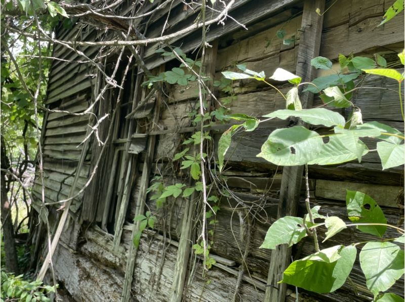

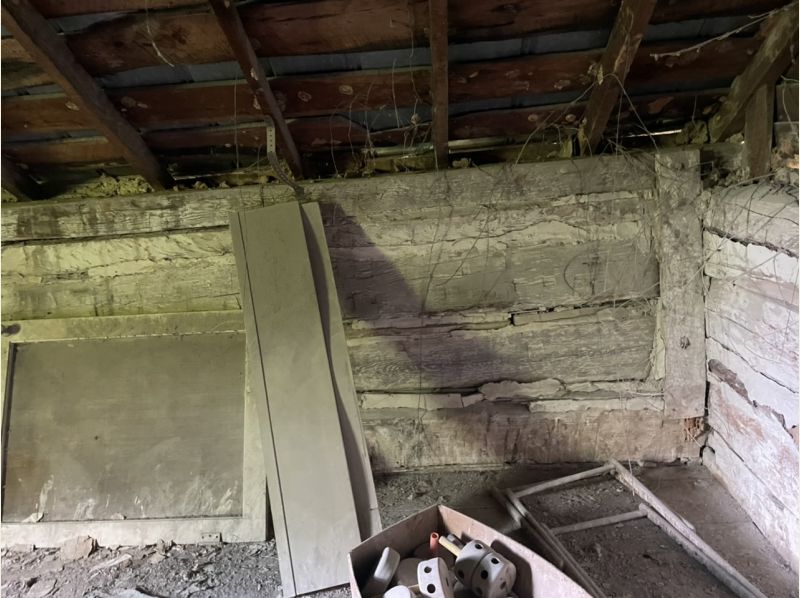

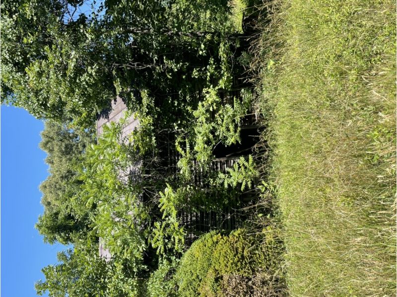

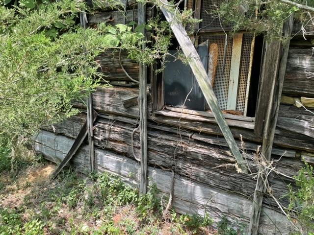

Hey folks new to the forum after searching the web to see if my cabin is able to be saved. I recently purchased a property in southern Virginia that has this old two story cabin on it. I’m told it dates back to the early 1800’s? Anyhow, is this thing able to be saved and is it going to cost me a fortune to do so? I got a quote for a disassemble/restore/reassemble and it was crazy.
This would be a basic weekend getaway cabin for my family to crash while we are hunting/fishing all day so I’m praying there’s a chance to deep clean it, replace some bad logs and replace roof/windows/door etc. I’m not overly optimistic but maybe there’s hope! Thank you!

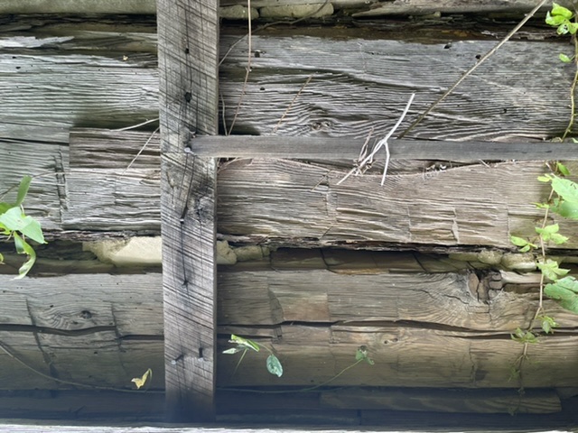

Pictures of foundation and roof. Anything can be saved. Get all the brush and junk away from it.

I’ll have to get some pictures of the roof/foundation next time I’m up there.

I'm torn back and forth between the nostalgia and scrapping it to build fresh. I spoke with a reclaimed wood guy that my wife’s company works with and he said each 6-7’ section of the logs is a $500-$750 mantle and he’s selling 3-5 of them a day in the Charlotte market. I’m guessing I could offload them to him for $300-400 each and there’s a bunch them with 2 stories.
The roof seems to be relatively weather tight now with no obvious water signs leaking into the cabin.

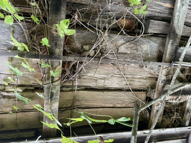

I’ll have to get back up there for some more pictures. It’s about 2 hours away so it might be a while. Here’s one that’s hard to see with the brush but your basic rusty tin roof.

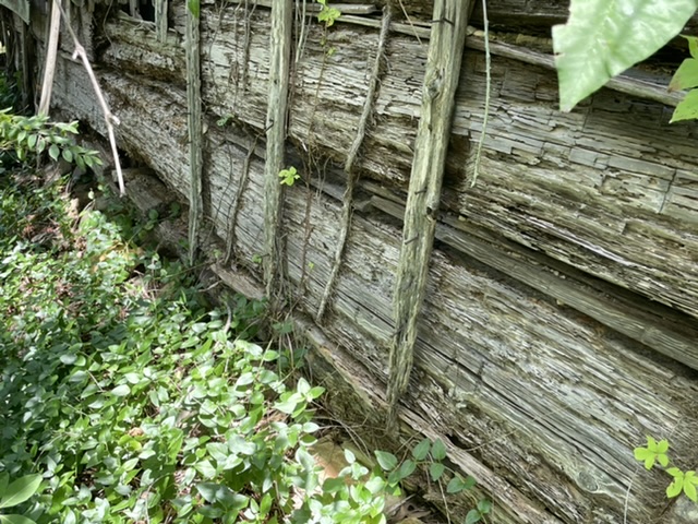

Foundation wise it looks like just up on some rocks. I’m wondering if I don’t get someone to lift it, remove the bottom two rows of logs which look to be the worst since they’re closest to ground and then put a block foundation down? I got a quote to move a barn 1000 yards for 12k so I’d hope that they could just support one while the new foundation goes in for much less?

Photo:

It is a money pit And a time pit......and I am a nostalgia/history buff.
If the 'foundation' is iffy you can blow the budget just getting it good underneath.
Is the present location where you really want a structure? If not, consider building a better rustic cabin, or even a prebuilt and tear down the existing house (I consider it more a 2 story house than a cabin) for the prev mentioned salvage to offset your costs.

IMO, you or I can not do very much structure saving, restoring and so on with $10-15K and do a good job that is not just a patch, especially if you have to hire out some of the work.
Supporting an existing structure, particularly a heavy log structure will require some serious efforts to safely temporarily support the structure while the faulty foundation is cleared out and a new foundation is constructed under the building. We have done some of this in the past with 6x6 and 8x8 timber cribs and large temporary beams. Lots of work; lots of dollars.
What about the structure makes you want to "save" it? Is it all old squared off hewn logs? If that is a major 'like' of yours, considering that some of the bottom logs are rotten and considering the foundation under those logs seems to be some rocks, give some serious thought to dismantling and rebuilding a new structure that will be able to last another century or two without needing additional work in a decade or two.
A friend in WV created an extremely nice cabin/home using old chestnut logs from a structure of similar age. After months of inspecting, measuring, and cataloging the timbers he designed a new cabin/home which was built on a solid full perimeter concrete foundation.
His original log structure also had some old lap siding. That too was carefully dismantled and much of it used for a stick-framed extension wing. The old siding was installed over a nice modern, insulated rain screen wall. It all fits together marvelously.

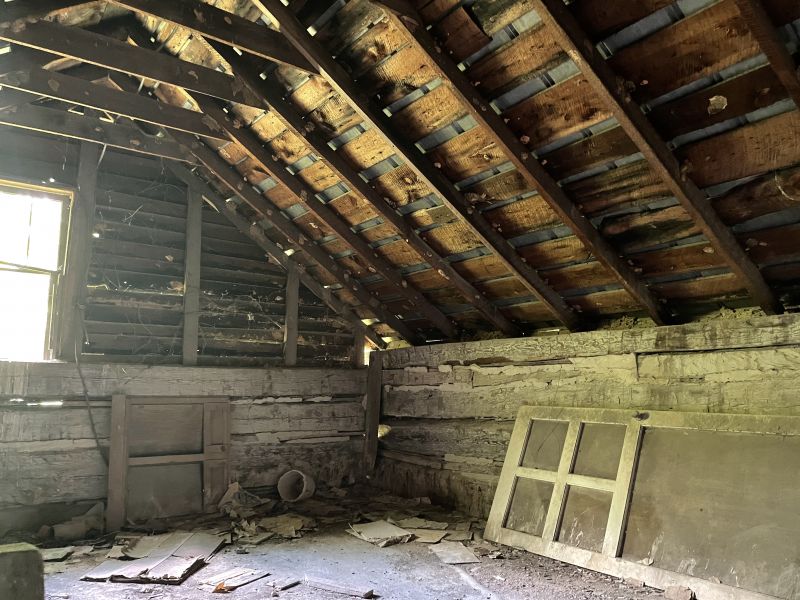

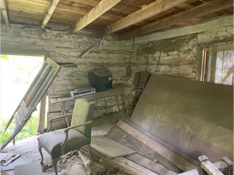

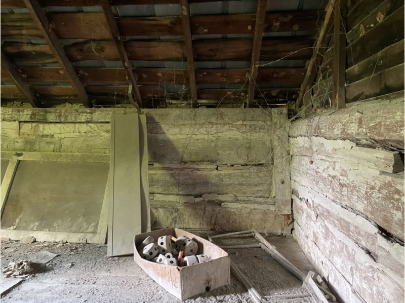

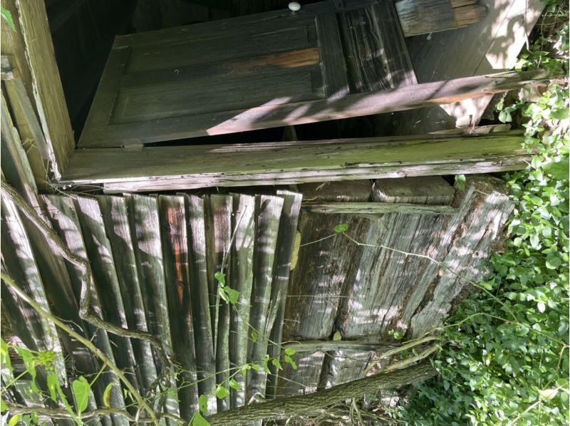

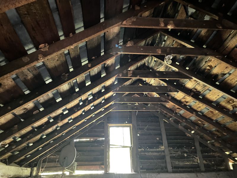

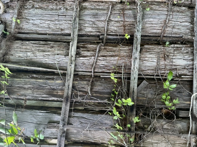

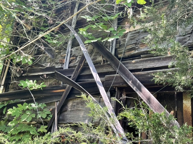

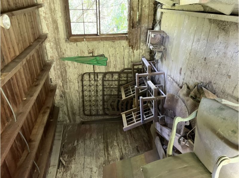

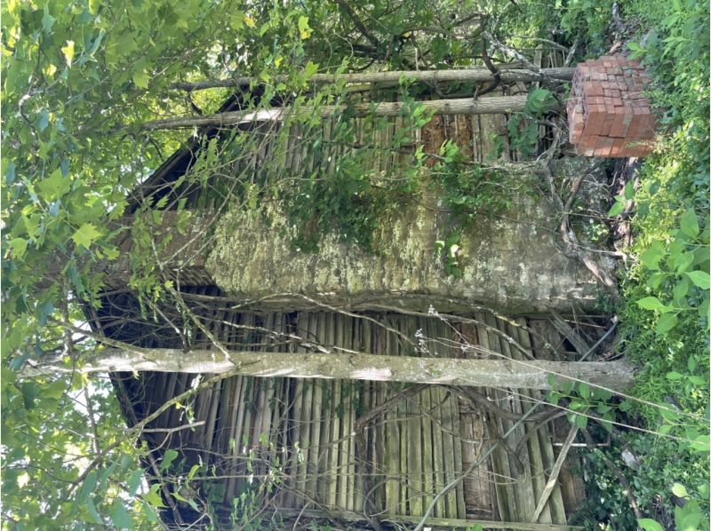

Got up to the farm today for a quick work day. I cut the the big vines, what trees I could and a did a heavy dose of roundup on everything from the cabin out to about 5 feet all the way around
After doing a close walkthrough/walk around, I think you guys are right and this one’s probably a bridge too far. Upper story logs are good and there’s a lot of good lowers but there’s some bad ones including one whole corner. Looks like a buzzard has been roosting upstairs
Updated pics inbound

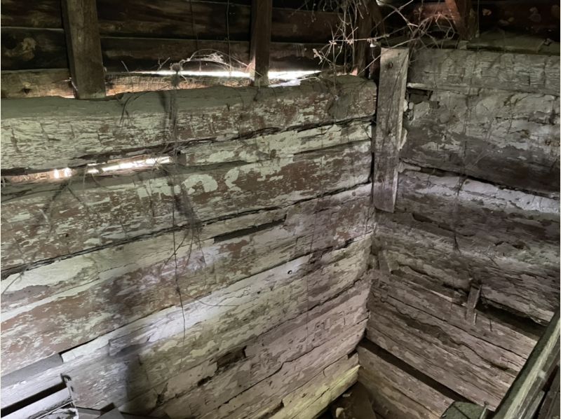

sixmilestill
# Posted: 17 Jul 2022 10:12pm
Pics 2

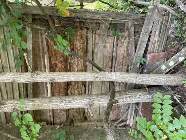

sixmilestill
# Posted: 17 Jul 2022 10:13pm
Pics 3

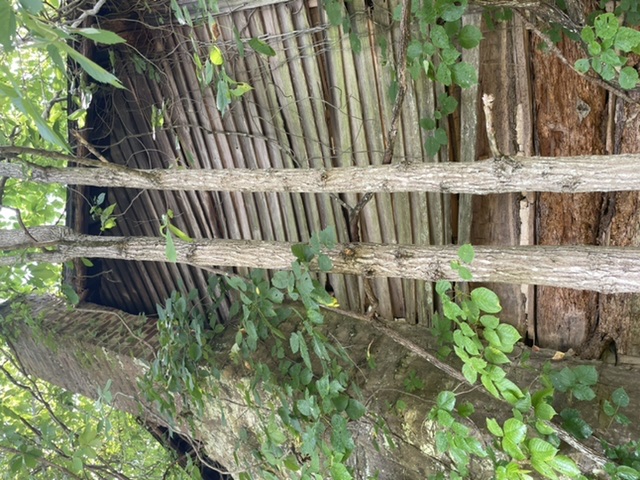

sixmilestill
# Posted: 17 Jul 2022 10:14pm
Pics 4

The 'modern electronics' are such a contrast to the place!
The more I see the more overwhelming it gets.
You might take a look at what that $10 to 15k would buy you for a prebuilt 'cabin' to move into the site. Get the shell and finish off the inside as you want, as you can.

# Posted: 18 Jul 2022 09:27am
I would try to save that if it was mine but would do all the work my self and only ever expect it to be a shed.
Is the first floor ceiling low or is that an optical illusion?
Right now here about $8k gets you a nice rough cut 10x20ft shed dropped off and leveled.

# Posted: 18 Jul 2022 09:07pm
It’s crazy in that corner it’s like the floor got lifted up but there’s no big trees over there or anything 🤷‍♂️
