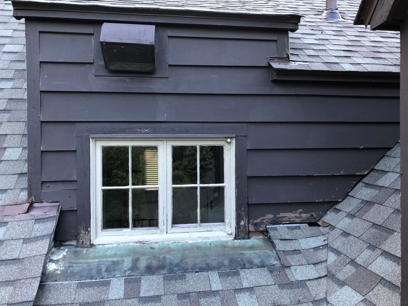

This is the situation as pictured. This is a new roof. The company seems to think the problem is in the old siding. I'm getting water in below on each side of the window area, but nothing obvious looks problematic. It needs scraped and painted to get by. I've looked carefully and caulked all that I can see that might be a problem. I know this is not a cabin. Sorry for bringing it up. It's driving me crazy, though. Maybe insight will help someone else.

If you can't see, the flashing does indeed curl up under the siding, as it is supposed to, on each side of the window. Those are the areas leaking, not under the window, but on each side below the siding.

That is a hot mess, there isn’t even any step flashing on the right side

I would completely remove that window. Its always going to be an issue and shouldnt have ever had the roof put up to the bottom of it to begin with.

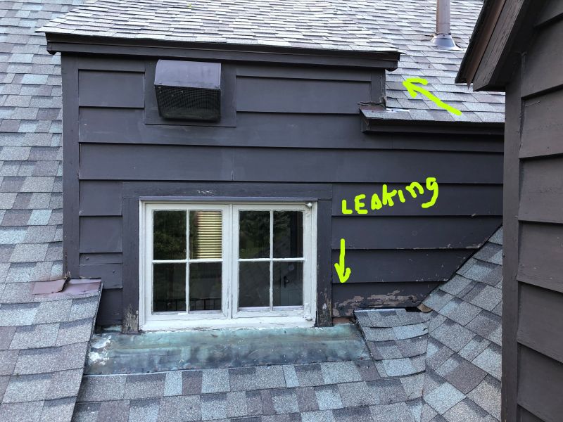

It's leaking below where the arrows are pointed. The copper flashing looks sound and curls up under the siding. I've caulked everything that looks suspect, but without success. I'm about to cover it with flex-seal after putting a new coat of paint on the framing. I know it should be torn apart and redone, but we've put so much money into other things, it's got to be just patched for now. Here is a pic with arrows showing where the dripping is at.

Put a garden hose on it. One small area at a time starting low and working up. Run for a while and check for a leak. Move hose and repeat until you find the leak.

The thing about water, it never seems to enter where the leak is spotted.
From your pic's, I would look upward to the corners of the siding and roof line to the right.
It may be entering somewhere in those areas and the lower part of the sill is the spot it ends up at and causing the damage.
When i need to search for this type of problem, I always look for its likely path to get where it shows the leak.
The shape of the siding and opening in the corners and gaps in the lap may show you where it comes in and this is the spot that needs repair even if its temp.

So, I think I solved this leaking problem. The arrow pointing up is where I finally solved the problem, I think. We had a heavy downpour and it did not leak, so I'm hoping it was the solution to the problem. There is a wedge or triangular shaped board that goes up the side of this shed style roof of this dormer. It was not sealed in anyway on the top edge of that piece of trim. For that matter, the trim piece was not cut very accurately either. So, I'm thinking the water was bouncing off of the roof and up behind the trim piece. It was too difficult to get a caulking gun in place to apply sealant. I had to put a piece of plastic hose over the tip of the caulking tube and spread it across the top edge of that rake piece which had flashing behind it, but was not protecting the top edge. Anyway, I did not use the Flex Seal product. I took the suggestion of using a hose down low and found nothing that leaked.
