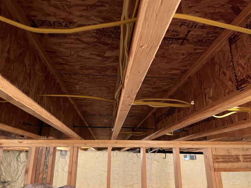

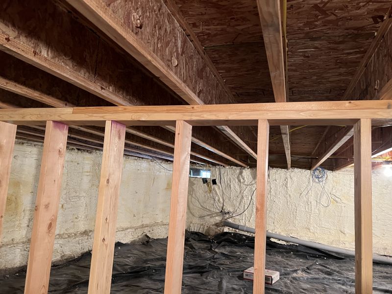

# Posted: 31 Jul 2022 11:30am
Attached are some photos

I would insulate the floor. I have 2 x 12 floor joist and R-30 in my floors. They never get cold in the winter.

Spray foam would be best, if price isn't a concern. I would avoid bats for the reason you stated, as well the fact that they can absorb moisture. If you don't want to pay for spray foam, then I would do foam board.
No, it's not uncommon to not insulate the subfloor if the perimeter of the crawlspace is already insulated.

You alreaty have spray foam on the walls. Do you close up the vents in the winter?
Why not just spray foam the floor? It can be done right over gravel or concrete. This would make any future leaks, repairs or adjustments needed easier. It will also allow for a heated envelope for your pipes.
