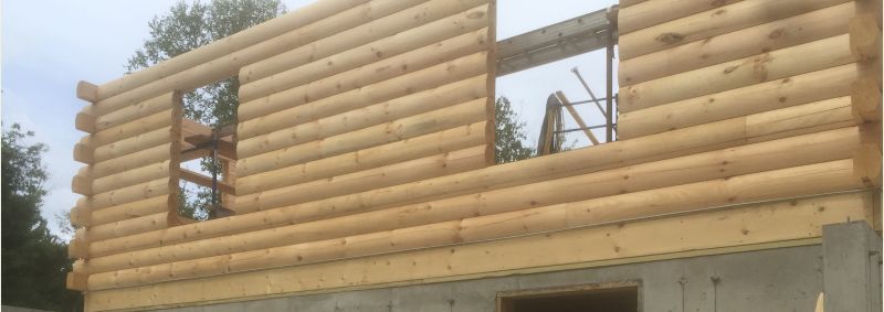

Im building a new cabin with log kit and im getting close to stain and caulking.
For the log splits: Do I caulk the splits first then stain over the caulk or vice versa ?
1st coat will be base clear
2nd coat stain
3rd coat stain
Thanks

Ime, any treatment applied to the wood before the stain hinders to prevents the stain from absorbing into the fibers.
I question the base clear 1st for that reason too?

So I should caulk after applying the stain ?

There are no caulks I know of that absorb stain or paint. So applying caulk first should be a no-no.

I just went through this in early July on my place. Based on A LOT of reading (mostly instructions on stain) and a few conversations with the log cabin supply place I come to believe the following:
1. Ideally you stain first, chink/caulk later.
2. If you're in a situation where you have to stain second, it's not terrible... but you have to figure out what to do with the chinking/caulking (either mask it, wipe it off, or leave the stain on) and that can be a bit more work.
We ended up staining first. Since the stain required a few weeks to "cure" we'll start the chinking next week.
As an aside, don't sweat it too much. You're going to be staining your place a lot more than caulking/chinking so you'll have to learn how to deal with it at some point anyway.

What do you mean by "splits"? The vertical seams where one log butts up against another, or the horizontal seams between the rows of logs? Regardless, I agree that the caulking should be done after the staining.

Yes I plan on staining first then caulk.
Did you stain before you put the windows in or after ?
