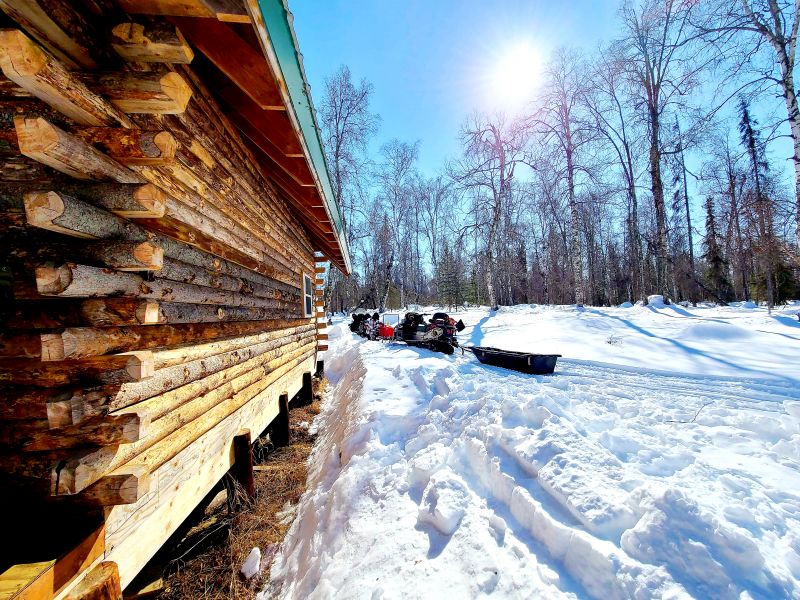

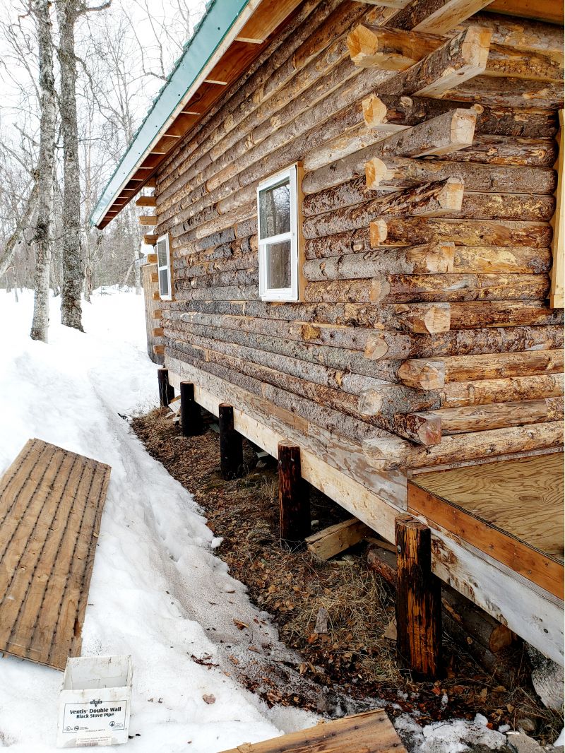

# Posted: 26 Aug 2022 10:59am
I had the same thought when we built our cabin. Keep the windows high enough so that the bears can't reach them as easily. And keep the snow that sheds of the roof from piling against the sides of the cabin.
We use recycled utility poles. They are cedar wood that doesn't rot. And easily to install with a 2 man auger used to drill the holes. Then cut them off level. I put a shoulder cut in the post and fastened 6"x 12"x 14' beams on them. Our cabin is 16x24 with a 4' front porch so 28' long. Putting the joint on a nice wide ledge. I used BCIs , manufactured floor joists to span the 16' using 3 rows of support beams.
This cabin has been through a 7.3 earthquake and gets tons of snow. Been there a while now. I checked the floor with a level last spring. Still right on it button. So it has proven up in my book.
Hey good luck n have fun. A couple pictures to see
Side of the cabin
Side of the cabin
Hauling fuel in the winter
