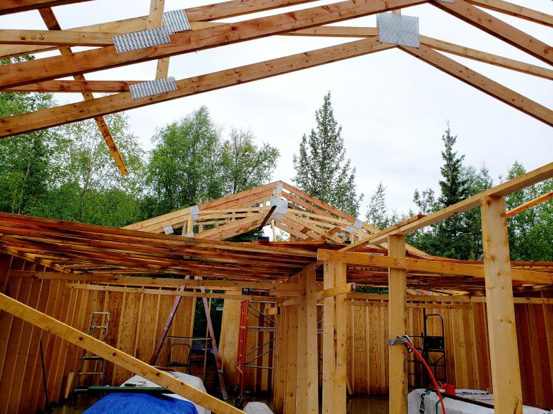

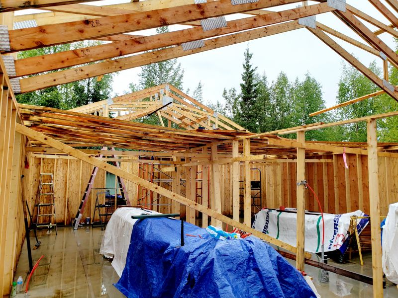

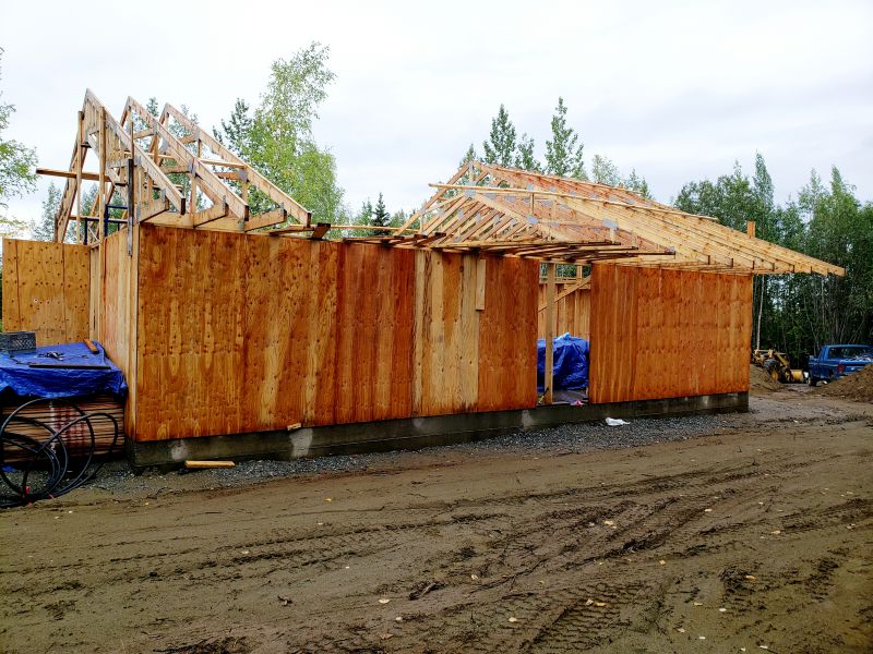

We just finally got most of our windows, Pellas, and a couple triple plane picture windows. Now I can get them framed in. Any suggestions on how to build the best headers ?
Rolling trusses
Rolling trusses
Inside
Inside
Looking up
Looking up
