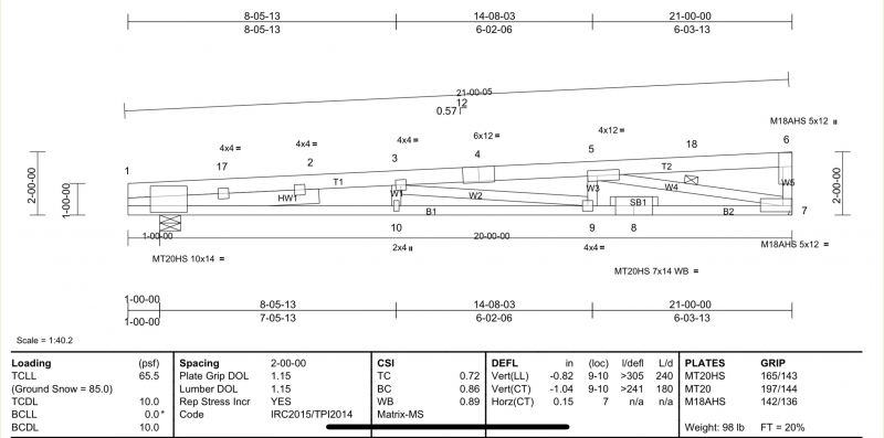

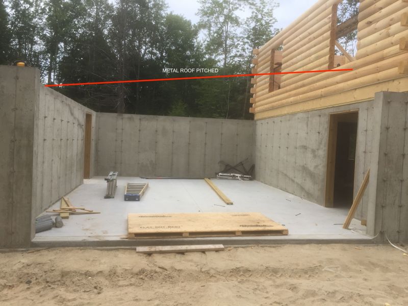

Im debating whether to do a EPDM membrane roof or standing seam for my garage roof because I was only able to get 0.57 pitch. It will attach to logs as you can see from picture.
I would rather go with standing seam but I was told its better to go with membrane roof to avoid future leaks. Im in climate zone 5 and it snows a lot so metal roof would be easier for snow to slide off. Thanks

That is my exact thinking too. With standing seam if any snow up there I can easily push it off the roof easily. My concern is flashing area where it attaches to the logs and want to avoid any log water damage since its hard to attach as it is.

They're exterior-facing logs, designed to be exposed to the elements. I wouldn't be worried about water damage to them, just make sure the flashing doesn't trap water against the wood.

The only slope i can get is 0.57 so Im thinking this might be better than EPDM roof which will hold snow longer till it melts. At least with metal Im able to push it off easily.
