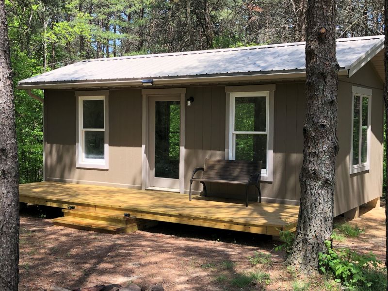

5" from Menards worked well for my 26' run. I spliced together using caulking and pop rivets and they looked really good. Here is a pic. Keeping them clean in the woods is a bit of a problem. I'm trying the 4" gutter brushes that are just what the title says, they are like a large diameter test tube brush, 3' long. You lay them in the gutter and the leaves and debris are supposed to not clog up the gutter. However, they do need pulled out every once in awhile and cleaned. Hope the short pine needle problem can be controlled.
gutter front
gutter front
