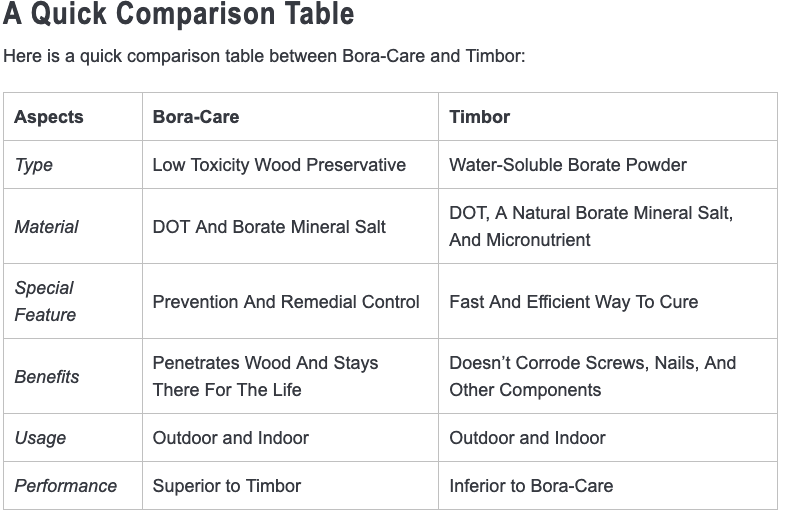

Do you think its worth it to go with Bora-Care for treatment of new logs ? It seems that Timbor sits on top of logs and Bora-care penetrates deep into the log.
Is the price worth it? Any thoughts ?

From the sheet you provide, both are the same material (DOT) so it's difficult to see how they would differ in their ability to protect wood unless there are other additives not listed or if there is some sort of difference in the concentration. Or perhaps the two differ in their carrying solution (water-based vs. oil-based?). Borate minerals are generally pretty soluble in water so if you live in a wet area, the DOT may eventually leach out of the wood (if
the wood gets wet often).
