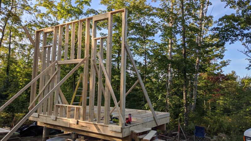

Hey all,
I got two of my walls lifted today, had a bunch of friends come over to help. If weather permits, hoping i get the other two walls up very soon.
A) I'm assuming I would sheathe the walls before i install the rafters?
(I'm doing a lean-to shed style roof, 4/12 slope).
B) For the sheathing do I install it from the bottom of my rim joist all the way to the top of the cap/double top plate?
(I built on concrete piers then built-up beams on top and then joists perpendicular to the beams)
(attached a screenshot of the first tall 12' wall up to give an idea)
C) See a lot of guides on gable roofs but not shed lean-to roofs....
I'm planning on doing zip system 1/2" over 2x10 rafters with the air gap ~1". Put underlayment on top of the zip? Then metal roof on top of that. Do I need the underlayment if i'm using zip?
was also thinking of possibly doing exterior foam insulation on top of the roof deck but it's getting crazy high ~16' at the top point now so might forgo that...
D) Do I need Z flashing all around the roof edge? Also above all the windows/door? And also at the top of the wall siding? Seems excessive?
E) I'm using advantech subflooring. Now that two walls are up, do I need to tarp it or just let it dry out after each rain? It's just spruce 2x6s and the subfloor so far. Worried about making a wind sail...
Sorry for all the Qs. Braindumping all my anxieties here. And really thanks y'all, my carpenter friends and your advice has really saved my butt.
Winter is coming soon for me so hoping i can at least get it weather proofed before snowfall in about a month. (I'm in upper VT)
first wall up
first wall up

Yo I am doing an almost identical build here. I attached the sheathing to the walls all the way to the bottome of the floor joists to help lock the structure together. I would suggest getting all 4 walls up so you can ensure your structure is squared up before sheathing. At least partial sheathing is suggested before getting at the roof. It really makes the structure more ridged when you start getting some sheathing on.
This is my first build though so I am pretty clueless compared to others on here. I did kinda a version of the roof you are suggesting against the advice of some folks on here. 3/4" wood boards, ice and water shield, foam insulation, strapping, tin roof. I have a pretty big overhang on the roof so didnt do z flashing on the windows and doors. Front wall looks really high outside but feels good inside. You doing a loft?
As mentioned this is what I have done. I would defer to some folks on here for proper procedure. Keep us updated. Looking good.

A) Put the sheathing on before the roof. It stiffens every thing up. I put the sheathing on even before raising the wall but the other way works too.
B) While you can use simpson ties to hold things together I always use the sheathing to do that. You can get 9' or even longer OSB that will be continuous from the top plate down to the rim joist.

A) Always sheath the walls before the roof
B) Always a good idea to lap the sheathing over the joists/rim joists as it adds a great deal of raking resistance to a wall. But then if the panels are not long enough to reach top to bottom you should be installing nailer blocking where the panels' edges are not supported/fastened directly to the wall framing.

I would sheath the walls before you even stood them up. Less ladder work but a mit more to lift. That wall dosnt look to big for a few people.
I think your going to be cutting it very very close on getting this weather tight before snow.
