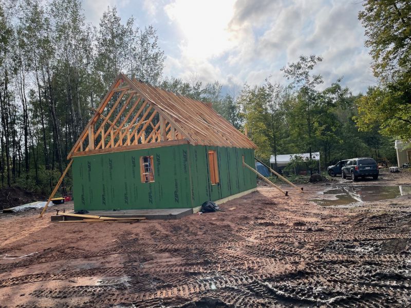

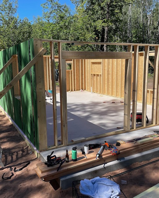

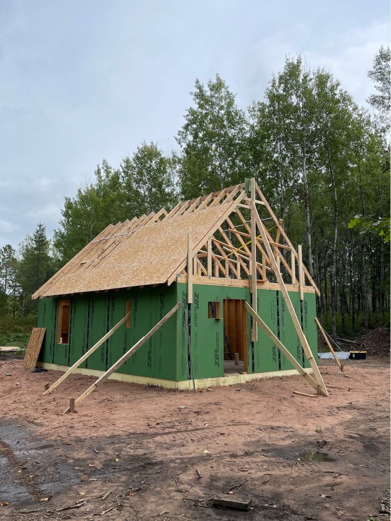

Long-time lurker. I've learned a lot on this forum and the dream is finally becoming reality. We put up trusses this weekend in a 6-hour downpour. Good memories but not ideal. They are up braced and stable and square. If you see big issues feel free to point them out but they may have already been fixed.
1) I'm exploring the idea of an unvented roof. We'll do exterior insulation on the roof supplemented with a thinner layer of insulation in the attic spaces. If you're not familiar: URL We'll have wood stove heat and eventually a heat pump mini-split in a year or two. I want to utilize the large space in the knee-wall area if possible afforded by less insulation on the inside. We're in Northern WI.
2) How do you properly frame windows in a gable truss? Build out the box with blocking? I'm not finding much online.
3)Our stairs come up through the middle of the building. The truss manufacturer had us ply trusses to increase the spacing to 3'1". Code calls for 1.5" sheathing over >24" spans. How do you make that one section thicker without sheathing the whole roof in 1.5"?

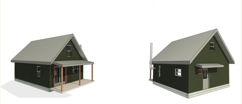

Thanks in advance for the help. I've attached pictures of Framing Front Back and the Design

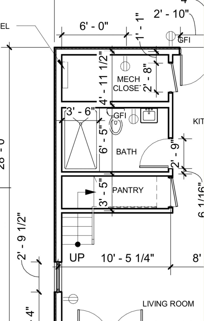

I assume your useing the up stairs for more living area? If so I wouldnt run the stairs up the center. That's prime head room in the attic.

2: I'd think you'd just frame a wall within the truss? You'll need something to catch sheathing anyway, right?

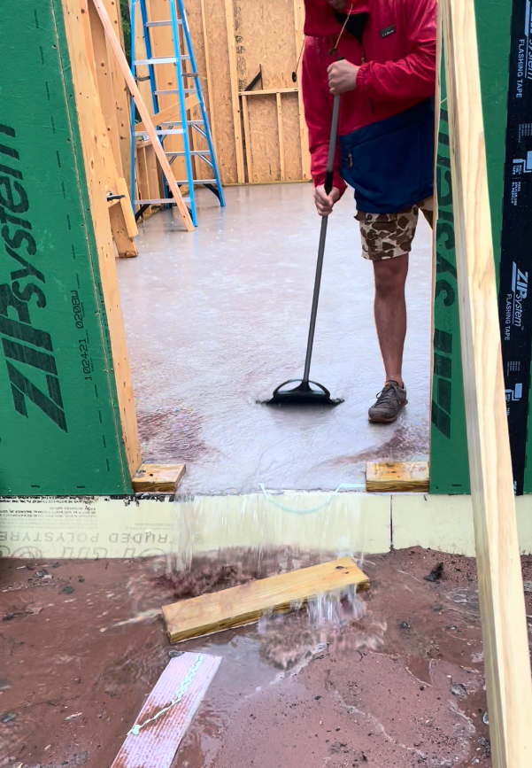

So. Much. Rain. The picture was every 20 minutes. For 5 hours. But when the boom and the help is there you have to move forward.

You cant have more than a 6ft wide area that's got 6ft head room. Dont take up any of that with a set of stairs. You can run them up the outside wall then turn into the middle of the cabin.
gedna002
# Posted: 20 Sep 2022 09:18am - Edited by: gedna002
Quoting: Brettny
Like this? These are the plans. Sorry I didn’t understand at first.
Plans
Plans
# Posted: 20 Sep 2022 09:36am
Yes just like that. Looks like you have a nice set of plans and have things well planned out.
