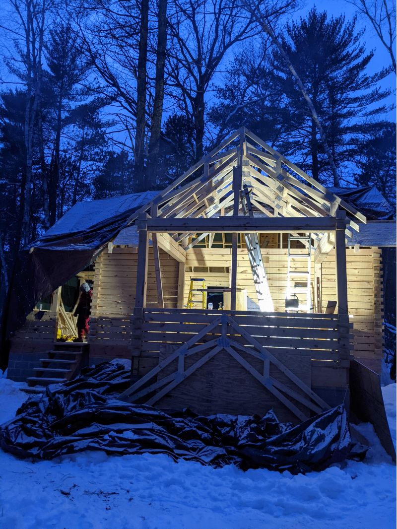

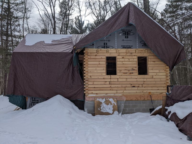

Not sure where you are in VT or how cold it gets but don't fret working through winter. I went into last winter (which was brutally cold and long) with no roof but tarps over a temporary ridge we put up with 2x4s. Spent a LOT of the winter pulling tarps down and putting them back up but had a roof on the place before it was all over.
MJH
# Posted: 22 Sep 2022 11:24pm
Meant to attach a few pics...

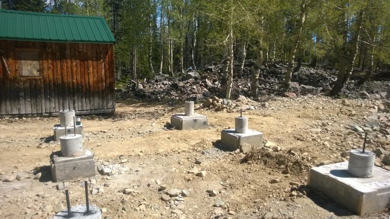

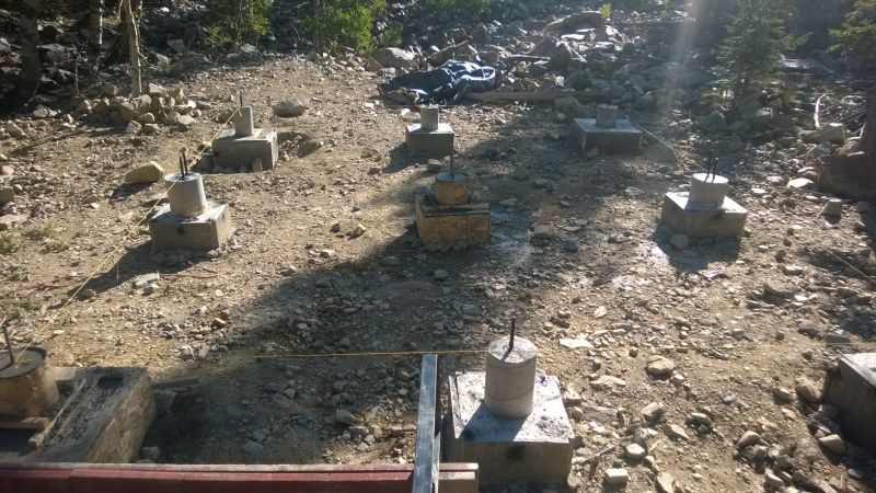

Our plan in the spring is..
1 weekend drill and place sono tubes. That week they get inspected.
1 weekend pour concrete.
1 weekend build and place everything below the sub floor.
3 day weekend build all the walls.
3 day weekend build and put up the 20' wide gambrel roof trusses. And get the roofing on.
So roughly 12 days with plenty of breaks, 1 inspection and concrete dry time. This is for a 20x32 with gambrel roof.
snobdds
# Posted: 23 Sep 2022 12:56pm
Quoting: Brettny
I hope you can do it. That part of my build took me an entire summer. It's not simple to align and set grade for sono tubes. I also beefed up my footings/tubes a bit. Each footing took at least 20 bags on concrete.

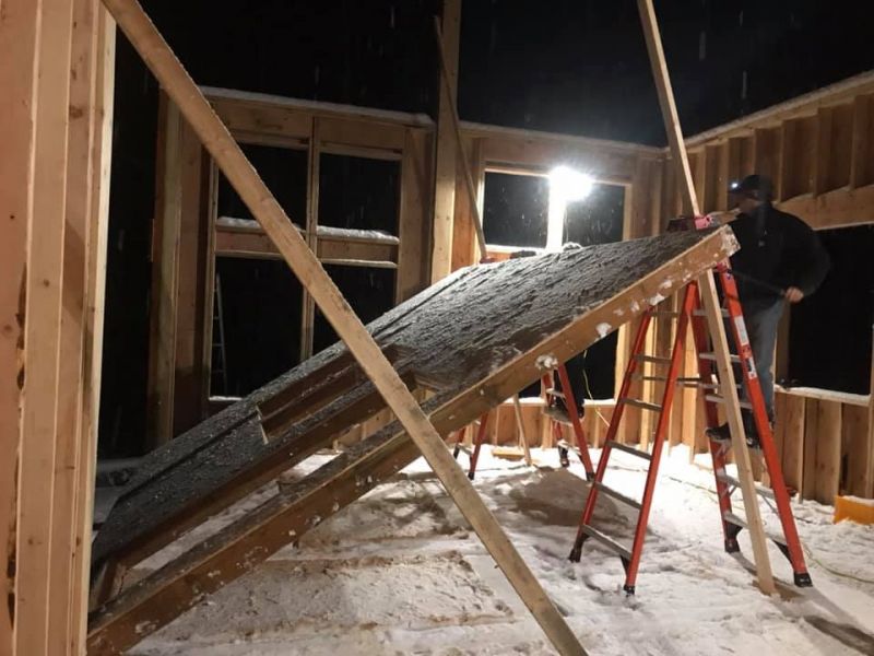

Us Alaskans must think differently then others. I agree, no need to panic and don't waste time with a temporary roof.
We got the walls up on the cabin I'm building in late fall during a snowstorm. Came back to it in late winter and shoveled 4' of snow out the windows so we could start on the roof.
