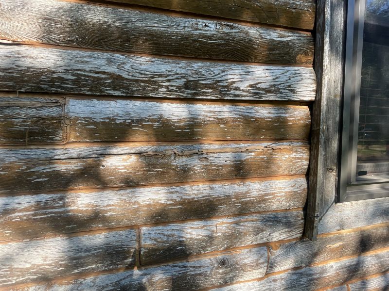

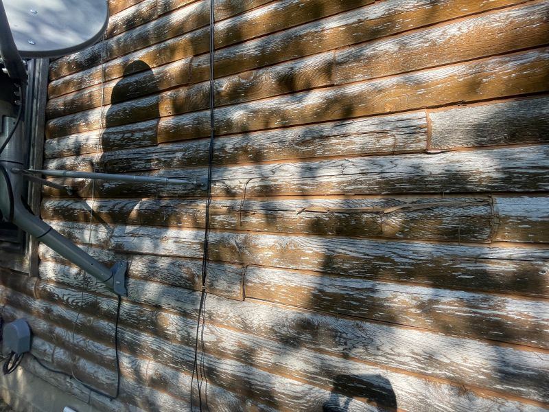

I’ve seen “log builder” is that what I should order or can I use something from a box store ? I’ve heard of chinking , is that what it needs vs caulk ? Thanks !

Is that 'log siding'?;ie, milled to look like log but nailed up to studs.
# Posted: 25 Sep 2022 05:33pm
I would say its log siding. Either way it's got some major weather damage and cracking.
# Posted: 25 Sep 2022 05:47pm
If it is, maybe remove it and put the top, less weathered/rough half on the bottom, the less good on the top.
If any needs to just be replaced use the new on the very bottom with the most exposure?
spencerin
# Posted: 25 Sep 2022 08:22pm - Edited by: spencerin
D-log siding is what it's called. Yep, Permachink makes good stuff for all things log. Those logs may be weathered and cracked, but as long as they're not rotted, they can have life added back to them with plenty of stain and sealant along the seams.
Since the seams are small, you'll want to use caulk, not chinking. Chinking is generally used for large gaps.

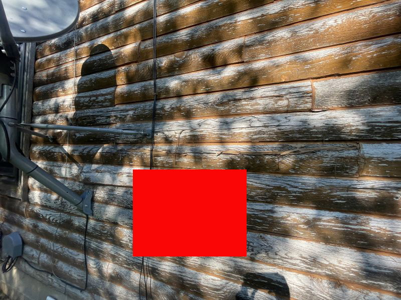

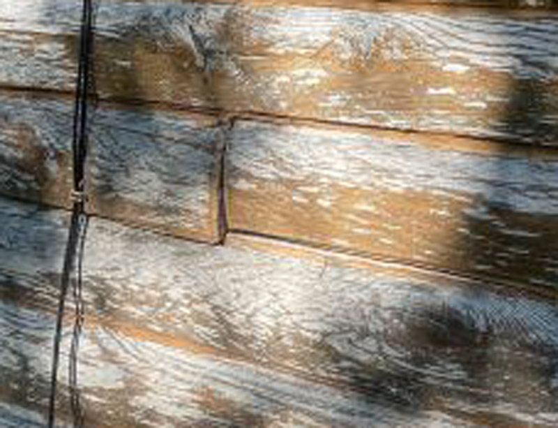

# Posted: 26 Sep 2022 02:48pm - Edited by: ICC
The wall is boards, not logs.
The first image below is what I snipped out of the posted image. In my 2nd image the red rectangle is the part cut out and enlarged to be the 1st image.
I believe only a board would warp out of place like that. There appears to be a large gap between boards that are nailed over something. To me that appears to be too wide a gap to be caulked without buy a truckload of caulking tubes. I know what I would most likely do.

# Posted: 26 Sep 2022 03:36pm
Yes, it's d-log siding. Very common. Round on the outside to look like log, flat on the inside to affix to flat surfaces.
Thanks for the closer look. Most d-log siding is t&g, so usually caulking is fine, but either yours isn't, or it's shrunk enough to create gaps. Now looks like chinking is the way to go.
