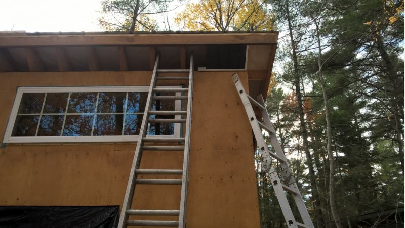

All these details about a shed style roof that I'm confused about and not much resources online...
Easy to add a soffit at the bottom side of the roof but what do I do at the peak? Do I try to build another soffit?
I'm planning to put blocking between the rafters at the top plates with a small gap at the top for air. With the soffit, I'm not worried since there will be a screen for bugs. But at the peak, if I don't have a soffit then what happens here?
Or do I only vent the bottom soffit and leave the peak alone?

# Posted: 27 Sep 2022 04:23pm
Making a soffit at the peak seems really difficult (peak is ~15 ft off the ground).
Other option im considering is cutting my blocking between the rafters down to have 2 inches of space between blocking and sheathing. Then I'll staple insect screen at the top of each bay?

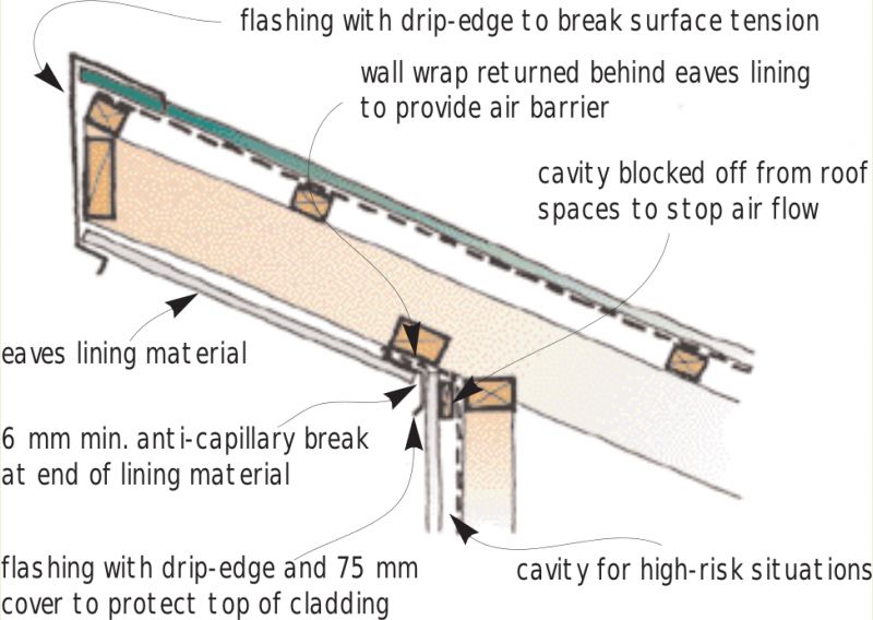

# Posted: 13 Oct 2022 09:39am
Would ideas in this drawing be of any help? Perhaps the top flashing could be set out a bit and the top of the sheathing cut back an inch to allow air to flow up and out through convection current created below at the vented soffit. Since the ribs of the roofing are gaps at the top, they would allow air to pass if the sheathing was opened up an inch or so at the peak/top underneath the roofing. I dunno if my idea is clear or not. That top flashing could be removed in the future to inspect for potential problems or to see that nothing is going wrong?
top of shed style roof
Tim_Ohio
# Posted: 13 Oct 2022 09:49am
Or, I suppose some openings at the top of the top fascia board could be drilled holes or cut slots to allow
air to flow out under the top piece of fascia flashing. You could easily staple screen across that, before installing the top angle flashing. If you want the face of that flashing to sit nice and pretty across the length, you could add some small block supports every foot or so. Just some ideas. I dunno.
