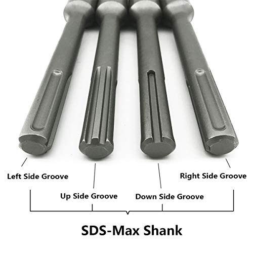

Can you rotate a bit like a clay spade/shovel in the chuck? So, instead of the shovel facing up, turn it 180*, or even 90*, so it's facing down or sideways, without changing the orientation of the rotary hammer drill itself, of course.....

SDS-Max shank
SDS-Max bit
SDS-Max bit

I'm thinking that is a "no".....
# Posted: 29 Sep 2022 08:52pm
Yes, a no.
# Posted: 30 Sep 2022 09:50am
Arnt all SDS bits in a rotory chuck? Put the drill in drill mode until its clocked the right way then back into chizzle mode.
# Posted: 30 Sep 2022 11:25am - Edited by: ICC
Apparently Milwaukee does have an adjustment mode where the position can be changed and then locked in. At least on the $700 model I saw last night did. Makes sense. I must have missed that or the off brand cheap copy I saw didn't have that.
snobdds
# Posted: 30 Sep 2022 12:15pm
Just put the selector to hammer drill. Get position. Put the selector to hammer.
