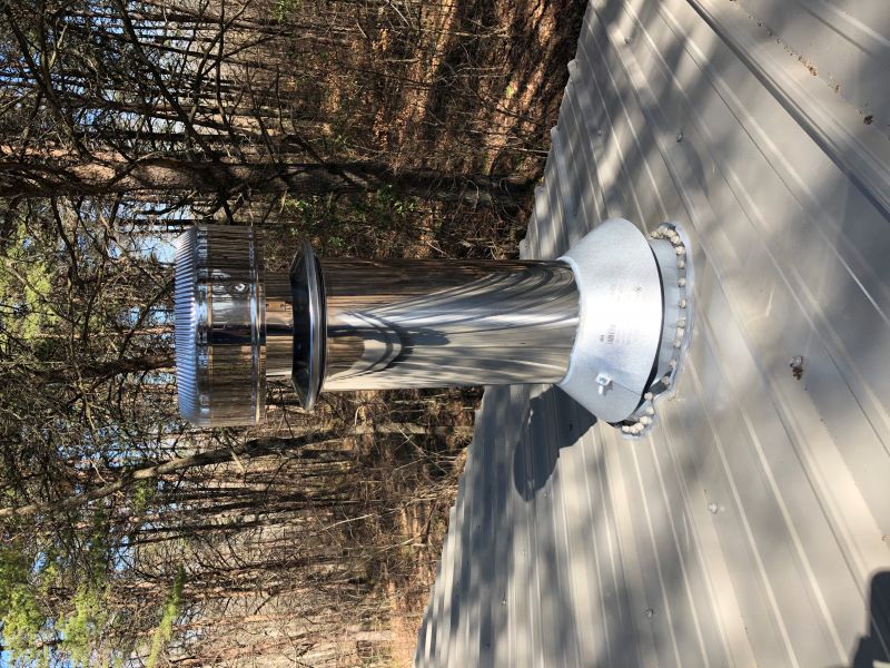

I used the gray with standard clear silicone. It's a straight run from a one story with double wall pipe only through the roof. I've had no problems and recently inspected it. Here is a photo of how it looked.
Tim_Ohio
# Posted: 17 Oct 2022 08:57am
Here it is.
Tim_Ohio
# Posted: 17 Oct 2022 08:58am - Edited by: Tim_Ohio
here it is
chimney
chimney
Tim_Ohio
# Posted: 17 Oct 2022 09:02am
Any tips on correcting the orientation of a pic. It's oriented properly in the original. I tried using a rotated version, but that did not work.

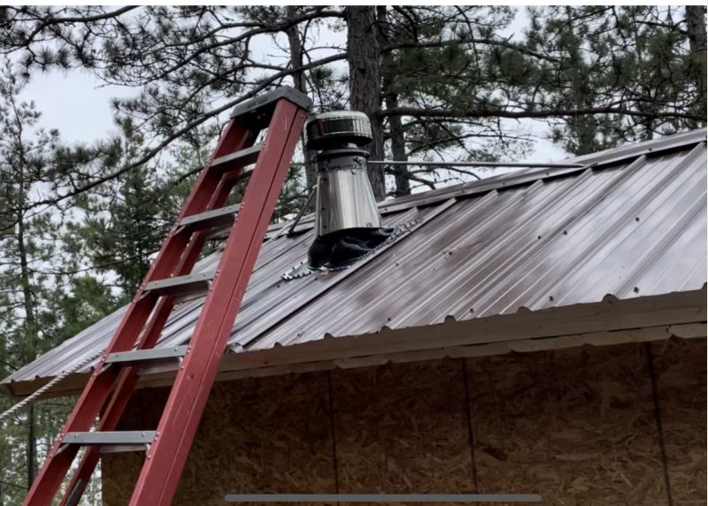

# Posted: 17 Oct 2022 09:11am
Tim_Ohio
So Tim. Gray- does that mean EPDM?

I think the only reason that Selkirk kit uses a storm collar is to avoid direct boot to metal pipe contact.

Yes. It is the EPDM. So far, no problems. Mostly, the storm collar protects the boot from damage by a tree branch or ice. It's pretty high on the 4/12 pitch roof and I did not think ice would be a problem there was not much distance for the ice to slide into it. It's been three winters without any problems.

Actually, I just realized I did use silicone. It was gray silicone and I forgot. Here is where I got it.
https://www.flashingsdirect.com/9-universal-pipe-flashing/
Tim
