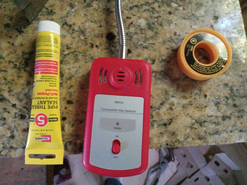

# Posted: 3 Nov 2022 04:04pm
Only sealant they had was this Rectorseal. New elbow, slathered it on, plus the other connections I had to undo. So far so good.
Too much electrical and plumbing lately, need to bend some nails.
Here's my gas detector BTW, works great, about $30.
