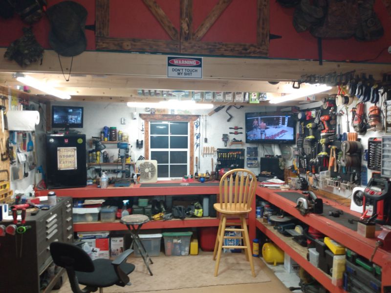

I have a shop with a double loft. I blocked off one end that I keep wood and other non delicate things in with a tarp. I like IGs idea of snaps. The other end I framed out like an old barn. With a double door access about 50 inches when open , to be able to put wider things.
No matter what you decide works best for you, if you can put a fan up there to push down all that precious warm air, will probably help a lot. I don't have a pic of the tarped end. I simply stapled the top edge of the tarp to the rafters. Then put a screw to hook the eye of the tarp in the middle, but still can flip it open wide enough for a 4x8 sheet of plywood.
Double doors/loft
Double doors/loft

Darz, that's a nice man-cave. TV, Fridge, & Tools.

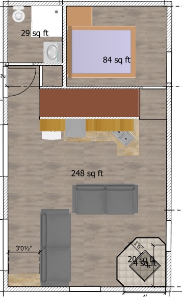

Its stairs up the center of the loft. Essentially we are a 16X28 cabin with a 16ft loft. When the fan is on, you can actually feel the air rushing up the staircase (at 1/2 setting).
When the fan is on high its a freakin whirlwind in there. It will push air even in the 2 back rooms (bedroom and bathroom).
Here is a layout of the upstairs.

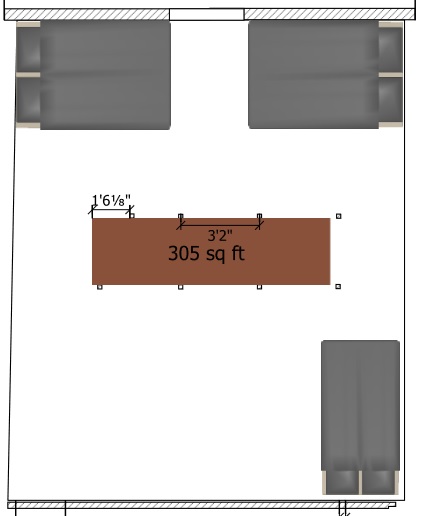

This is the mainfloor in case anyone is interested. The fan is powerful enough to push air all the way to the back. Its an industrial fan, no bells or whistles (or lights). Just pure air moving power.

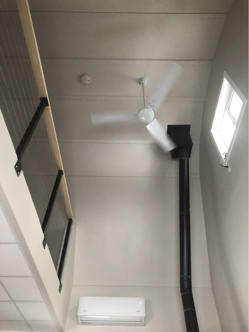

I am able to get my loft to within 3*F with a large ceiling fan. Its a typical loft setup with stairs on the open end. I do have grid power so that makes it easier to run the fan around the clock when I'm there.

# Posted: 29 Nov 2022 11:56am
Good point, to clarify I have a large fan 84" in the cathedral ceiling and a 54" in the loft itself....it regulates to a 3* temp difference between the downstairs and the loft....
