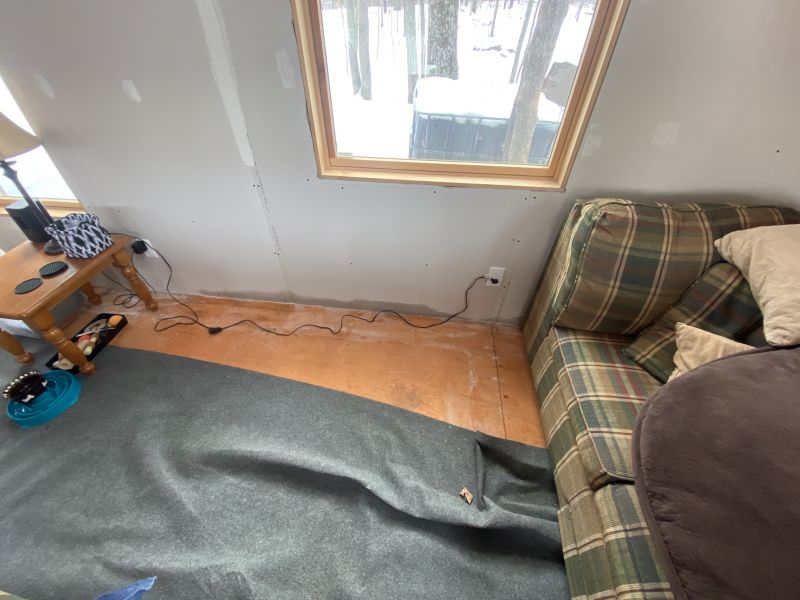

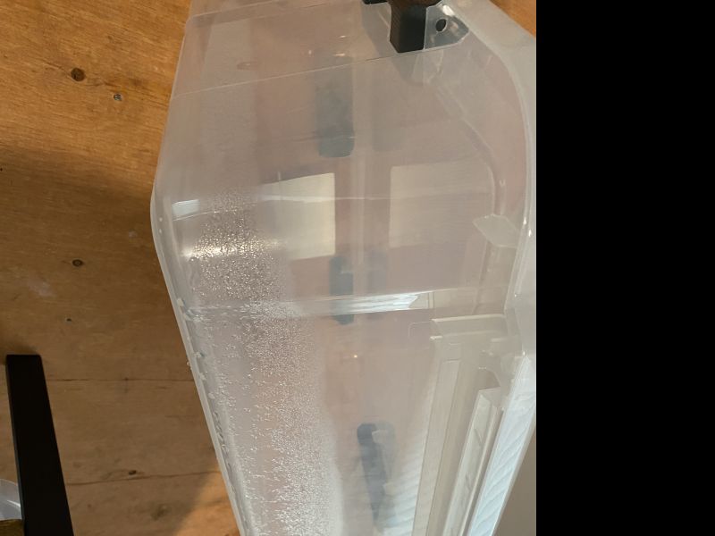

It was a bit chilly this weekend, highs in low teens and single digit nights with a decent wind as well. Inside the cabin we kept it between 68-74 with the pellet stove and the ceiling fan on medium. This morning however as we were packing up and cleaning I noticed anything that was sitting on the floor or against the wall was wet or iced. So places like behind the couch that’s against a wall, plastic totes stored under the bed, dog bed laying on floor ,etc.
my assumption is that this is due to the cabin being elevated and my floor not being insulated and the warm air inside not being able to circulate and move through those areas. Is that right?
If so, how do I avoid this? I mean I can move stuff away from the walls but I can’t defy gravity!!
Lastly, how should I handle the moist spots on the drywall? Hair dryer? Space heater that will blow on it?

You can dehumidify with "DRY HEAT" such as Electric. You may also consider a dehumidifier but they suck energy as bad as an electric heater. Once that moisture is IN the walls you'll have other problems appearing (or not) if black mold sets into the walls or saturates the drywall then it is a health hazard that is very hard to deal with.
The BEST thing to do is to insulate your floor, and have a Heat Recovering Air Exchanger (regardless), and do use an exhaust fan in the kitchen when cooking and in the bathroom when showering etc to prevent introducing more moisture.
Now if your walls are actually cold and you did insulate that may be a sign of other issues within the walls. Anything from critters having gotten in and nesting within (listen carefully for rodents), shifting/sagging insulation and such. I have ripped walls open only to discover large mouse habitats in some houses where they chewed holes into the sheathing between the siding, or entered from the roof cavity.
A buddies 40 year old house was infested and appeared with symptoms of cold exterior walls and condensation on them, we cut a few exploratory holes and mice fell out of the fiberglass... All teh drywall had to be removed along with the remnants of insulation and redone, we found several entry points in the sheathing and from the roof. Lucky for him, we could DIY it otherwise the cost would have been insane.

The elevated and uninsulated floor is much of the problem, IMO. Insulating it will help a lot.
Heating the interior with a wood burning stove, including a pellet stove, should not raise the humidity. The relative humidity will fall as warm air can hold more moisture. It is quite possible to see some condensation on any area that remains cold because of poor insulation or air leaks.
FWIW, my cabin has R25 in the floor joist bays as well as code or better in walls snd ceiling. We have ceramic tile over cement fiber backer board on top of Advantec sub floor throughout the cabin. Heat is primarily a wood stove once winter sets in. It never takes more than 24 hours to get even the tile floor to be warm enough to use the cozy adjective. If the insulation is sufficient and well fitted and the structure has no air leaks that should be easy enough to achieve.
I know this next comment will not help the current situation, but it may help someone in the future. Drywall should never sit on the flooring. There should be a 3/8 to 1/2 inch space under the lower drywall edge. We use a foot jack to lift and hold the panels off the floor while it is screwed into place.
