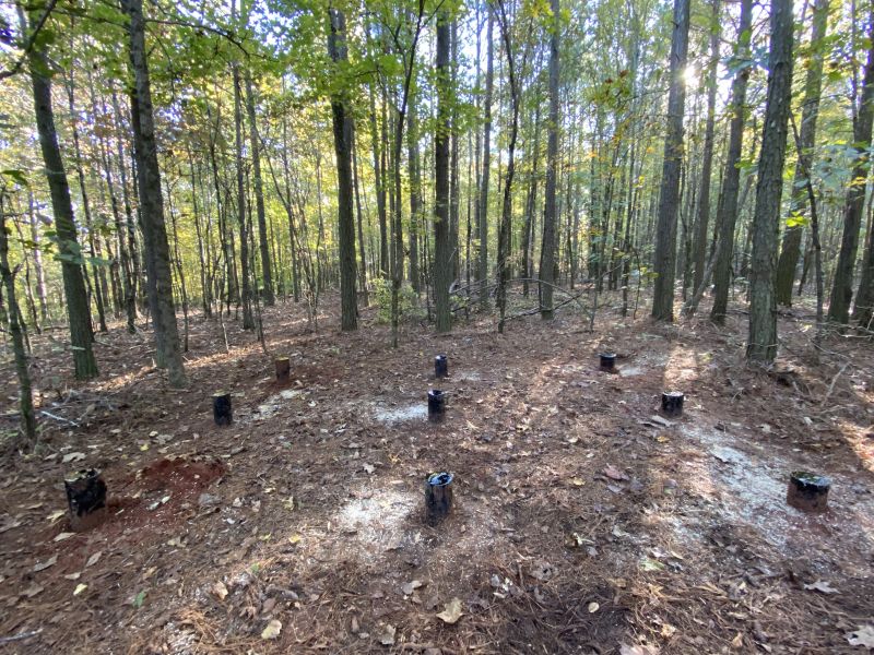

I live in North Alabama and built a 10x16 cabin on posts but decided to try something a little different. I dug down three feet and put a foot of gravel at the bottom. I had cut some 12 inch trees down the year before and cut them into five foot sections and let them dry. I then painted the with very VERY thick fence paint and then put them into the holes and backfilled. It is clay so it has settled pretty quickly and now that I have a cabin over the posts nothing gets wet. It was a pain to do but my little cabin sits on nine posts that have not moved an inch and being on gravel drain better than it on concrete. Just a thought.

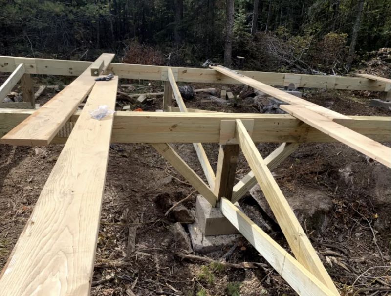

I poured up to grade, then filled concrete blocks and put j-shaped threaded rods into the concrete. To that I attached bolt-down post bases for the 6x6 posts.
Cross bracing is key to making it solid. Good luck!!
