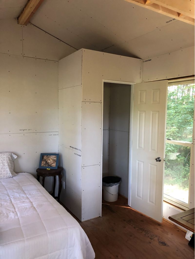

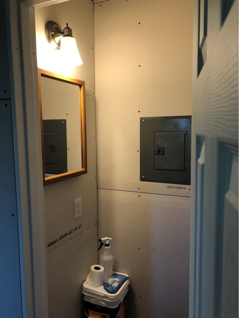

# Posted: 14 Dec 2022 10:09am
Although my bathroom is very small, about the size of a phone booth, I left the tops of the walls open on two sides. I like it, since I can leave a night light plugged into the outlet in the bathroom and it lights up the ceiling for a little help finding my way around in the middle of the night. My cabin is without plumbing, so it's just there to serve as a private place for doing your business. It has a medicine cabinet with a mirror. I'm trying to figure out the best way to install a tiny sink, even if it's just draining into a container, for brushing teeth or washing off your hands.
Anyway, I like that I did not tie into the ceiling. It's located in a corner and the open ceiling goes up about 1.5 ft over the farthest wall, I think.
