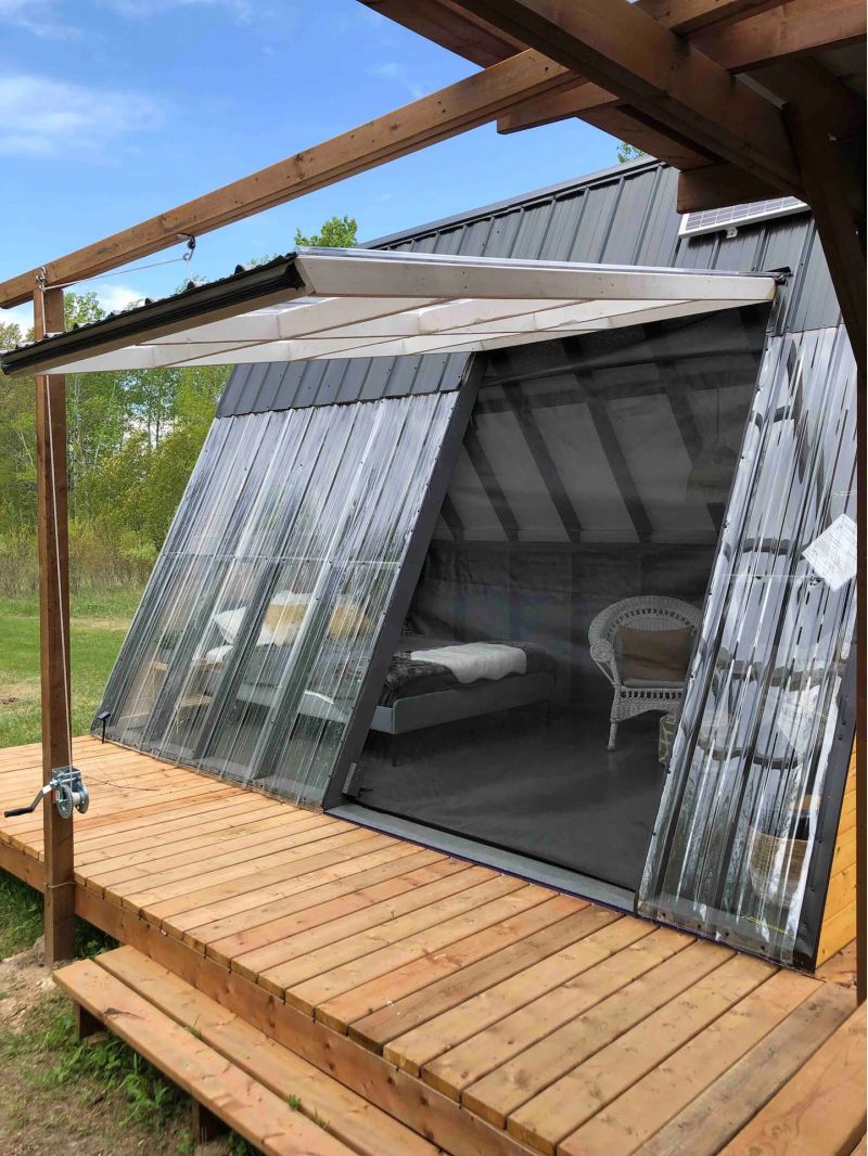

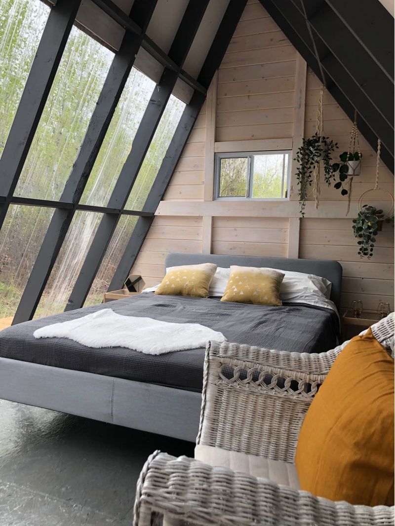

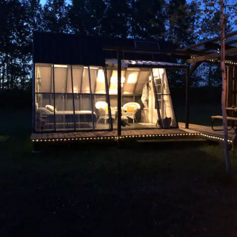

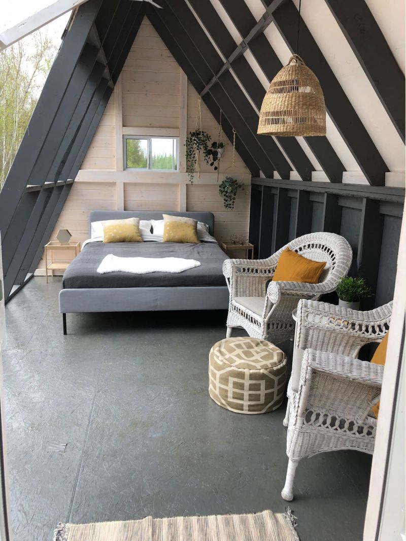

here is what my tiny A frame looks like. 6 sheets of 4x8 plywood. it not a hunting blind, but building a small one for hunting should work great. 1.jpg

So guess it could work but I see somethings that might be a problem. You will only have 2 walls that can have shooting window- the two vertical ones. If you try to put any in the A roof panels they will probably leak if closed and will let rain in if left open to shoot.
Angles- I hate building with anything other than 90 deg, lol. It just get more aggravating to me.
To me a 5x5 box stand with 3 windows is about right for 1 adult, 5x6 and you can add a small kid, 5x8 is good for 2 adults

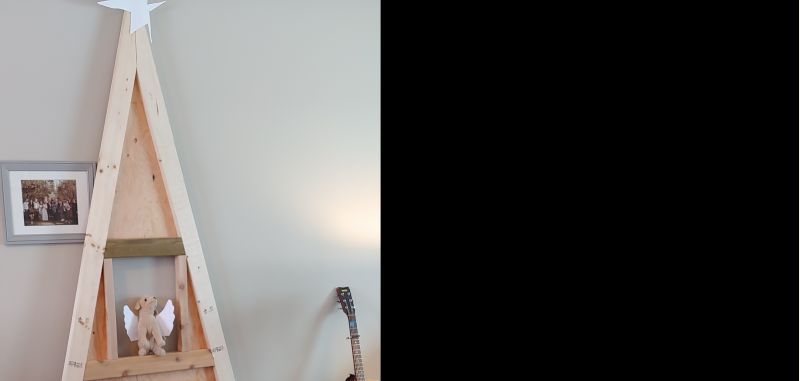

I appreciate the feedback. I put together an end wall to get an idea of what it would look like. My daughter turned it into a nativity scene. Gcrank is right, I think about extreme cramped quarters. But for purposes of just sitting in front of a window, standing up to stretch, lying down for a nap and holding snacks and a tiny stove, I still think it works. The photo is cropped for some reason. For perspective, note I can easily crawl through the window (not that I plan to).
# Posted: 26 Dec 2022 10:50
Nice job of multi-purposing! That size will certainly define your 'man-cave', lol. A few more sheets of plywood and 2x4s and it could be something so much more than a tall pup tent. Say: Deck 8x12 roof on the 8' sides widens it out (avoids the squeeze) and gains more shoulder and head room. make each roof section 12' high So, 10 sheets? Id want to make an overhang of roof around the edges too. We had an Aliner camper that was about that size (look em up!) for 10yrs and it was a nice size for two, fantastic for one. That probably takes it to Mini from Micro for you but I think you'd grow into it.
