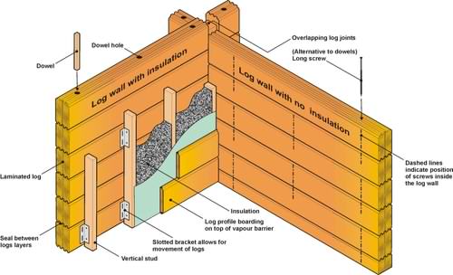

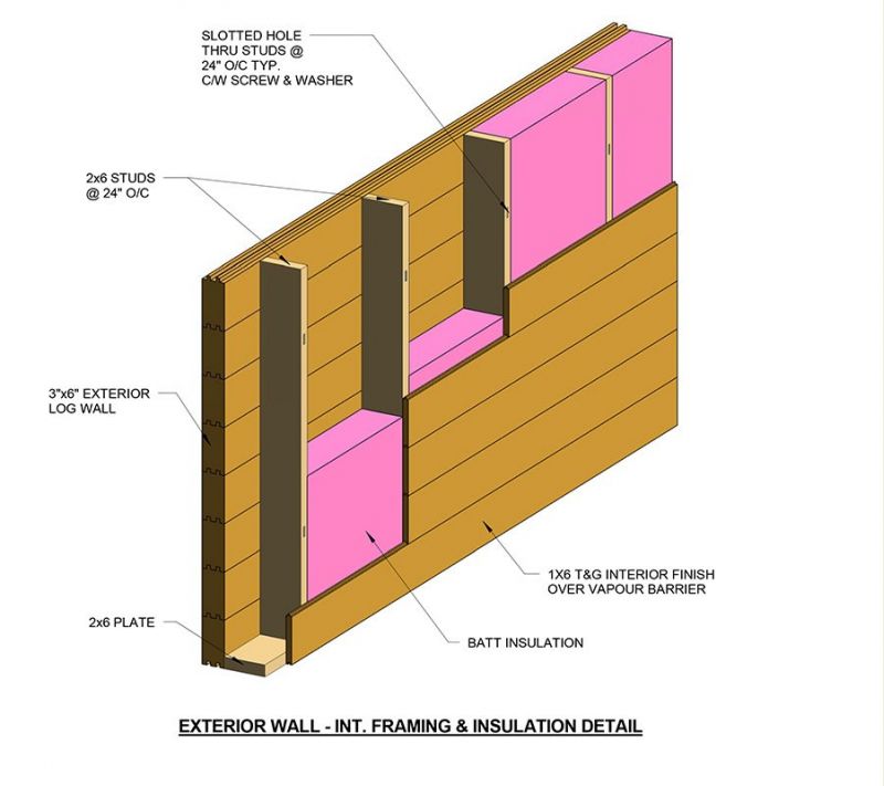

Im looking to put additional insulation on the inside of the logs before I add tongue & groove.
I was thinking of adding 1" rigid foam then add tongue and groove on top.
Similar to the image attached.
Do I strap it and then add tongue and groove? Or just add foam board then just staple directly into logs ?
Anyone done this before ?
inside wall
inside wall
wall system
wall system
# Posted: 16 Dec 2022 12:10pm
I wouldnt to either. I would put the 1in foam directly on the logs and screw furring strips through the foam into the logs.

# Posted: 17 Dec 2022 02:13pm
No need to use studs in between the foam sheets as you show. Fit the foam sheets against the inside of the wall, butt the edges and tape if you want the best air tightness. There are round plastic washers that can be used with screws to hold the panels in place while you work.
As was suggested you can use 1x4 boards secured vertically over the foam with screws that go thru to the studs. Then fasten the T&G to that in the usual manner with nailing thru the tongues.
Staining and applying at least one coat of clearcoat before installing the T&G is a great idea. Sometimes when T&G is stained or painted after installation and the wood dries out more there can be color gaps in the v-joints of the T&G.
It may be worth your while to go to 2" foam. ???
Two layers with the seams staggered make for better air sealing but may increase the cost.
