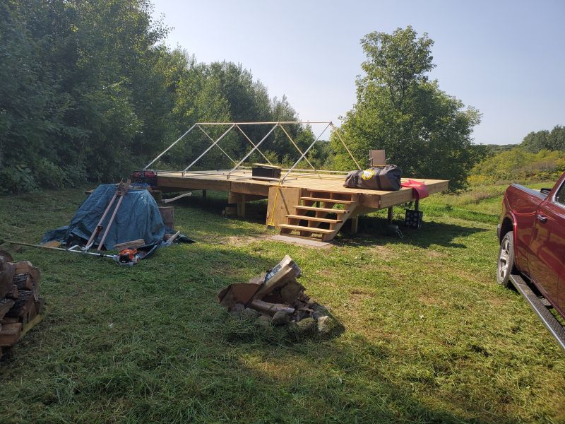

Hello everyone. I built a deck to put up my Montana Canvas 14x16 tent. The heavy snow we had collapsed the tent frame. So I am looking to build a small cabin with a 1/2 loft on the existing deck. I live in Western WI.. The deck was constructed as follows. 4x4 posts(9) set in concrete below the frost line. I have a 4x10 beam spanning the posts with my deck was framed with 2x8 lumber. I attached a picture so you get the idea. Will this be ok to build a small cabin on or should I add additions footings? etc?[img=null]null[/img]

I think that will work fine for a "reasonable" cabin. My only concern would be that the piers with the 4x10's not being directly tied together. That could allow racking to shift things. It may be prudent to run 4 2x10's between the 4x10's to lock them together. The deck is good & solid from what I see.
I'd suggest building "light" using Advanced Framing (less wood) @ 24OC, use a light siding material and tin roof as well to cut structure weight and maximized lifecycle. Insulation Materials can be quite deceptive for weight, so be aware of that as well.

Thank you for the reply. I was thinking of adding 2 more 4x4 posts on the back corners(towards the woods) as it does cantilever out over the beams a little.

If the vertical posts are in the concrete down to frost line I think it will be fine. You get very little racking when your post goes feet below ground. You have 2x8 floor joists only spaning 8' correct? And 4x10 beam only spaning 7' correct? If so I think it's more than adequate for a 14x16ft cabin.

You are correct on general spacing and material sizes. We used this for the last 3 years and noticed no racking.

The difference now is that you are intending to add a couple of thousand pounds on top of that platform that will be there all the time.

If the vertical posts go all the way to the frost line like they said there will be no racking.
# Posted: 26 Dec 2022 10:32am
Just thinkin though....based on some of my less than stellar projects....
It will be fairly easy to get under there and strategically mount diagonals and probably never have to wonder or mess with it again.

If the concrete went right up to the bottom of the 4x10 beam you wouldnt add diagonal braces. Why do it now?
# Posted: 28 Dec 2022 09:20am
I would install diagonal bracing from the bottom of the 2 outside posts to the top of the 4x beam in the middle. Do it on the inside if possible so skirting could be installed easier.
