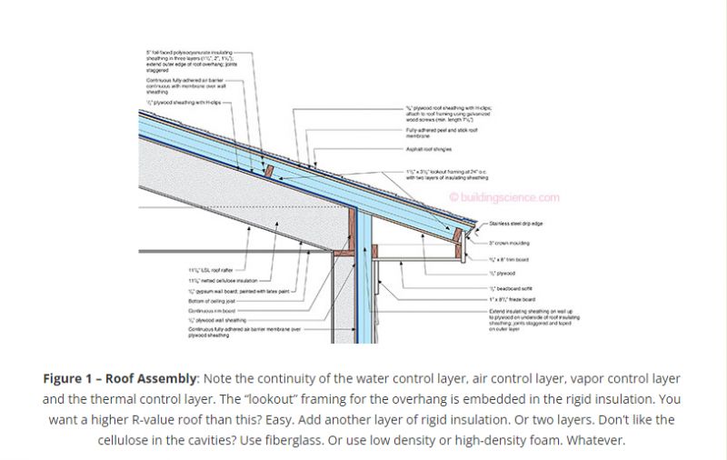

# Posted: 24 Dec 2022 02:58pm
We have some diagrams previously posted on other threads (Steve S?) that show the layers of 'new-generation' building techniques that look mighty sensible for insulation, venting, rain walling, etc. Without a doubt Id be using them from the ground up were I building fresh. Would be nice if somebody could re-post the pics here so we can be keeping them in mind

# Posted: 25 Dec 2022 07:52am
Roof and wall insulation.
