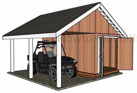

I am looking for thoughts and opinions on my idea. I need some more covered storage for tools and equipment and came up with the idea buying half of a 24x24 two bay prefab garage to be dropped on a gravel pad so that I am dried in immediately. This would leave me with 12x24 single bay that I would then build a matching 12x24 open lean to off the side for tractor implements. I spoke to the manufacture and they said the would have no issue customizing the single section for me.

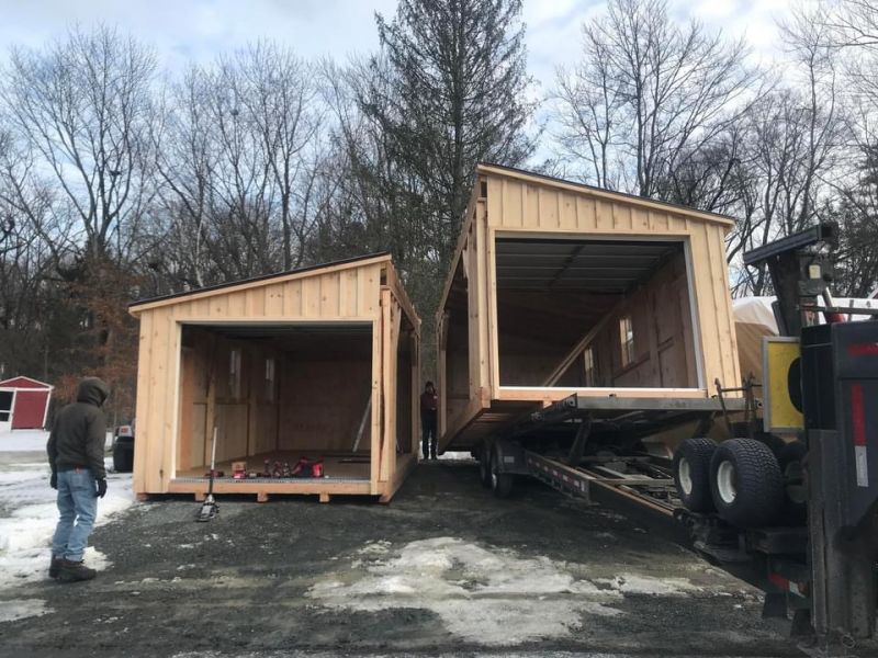

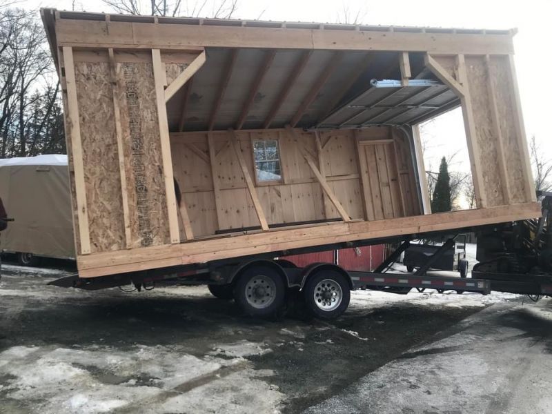

Fwiw, I was in the same situation at the cabin property of needing a workshop/toolshed structure and NO time.
This past summer we bought a prebuilt 10x16 mini-barn. I had all I could do to clear and prep the site and it was delivered and leveled in short order. Kinda pricey but I was able to accomplish a lot of work at the place that I couldnt have done if I was building the shed. The trade off of money vs time and being able to move ahead quickly was way good.
