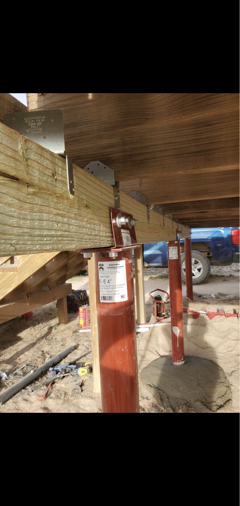

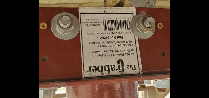

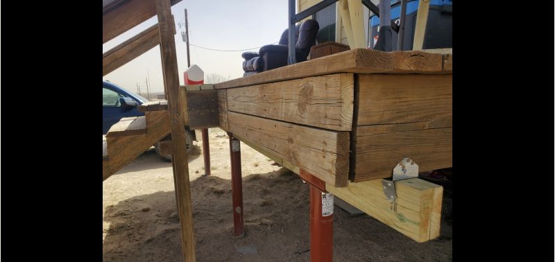

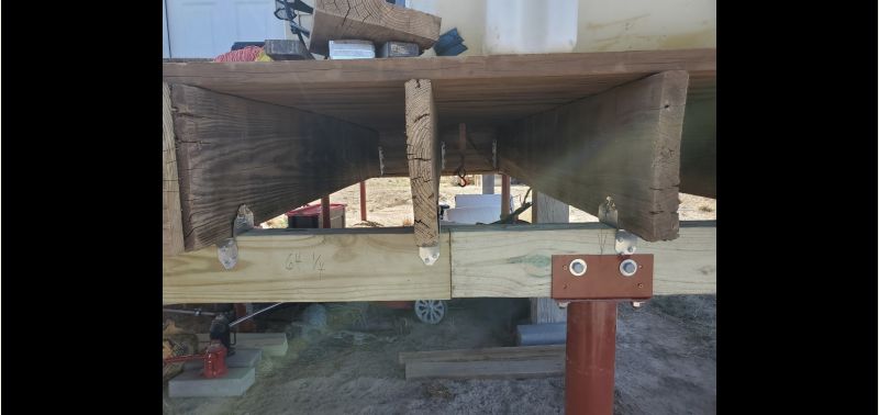

Here's the pictures.

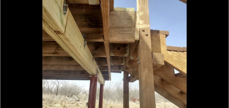

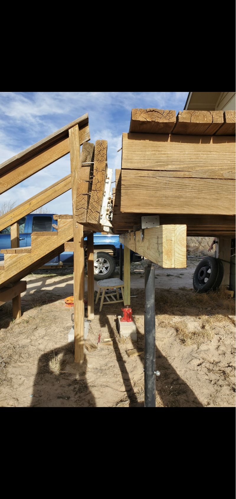

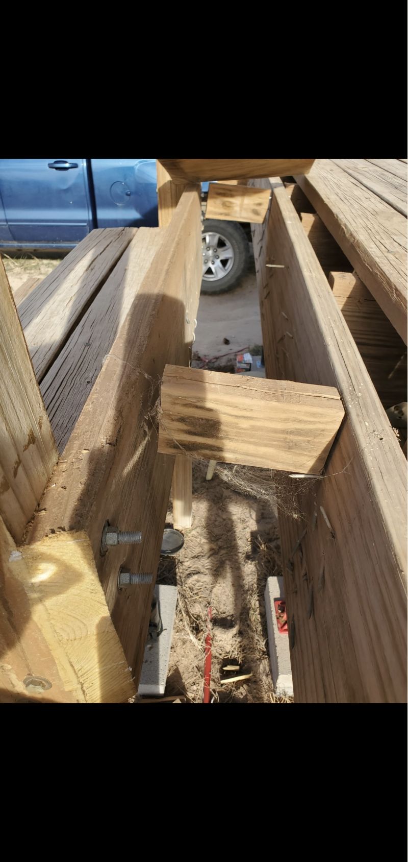

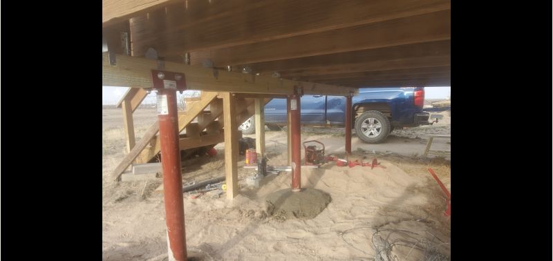

More pictures.

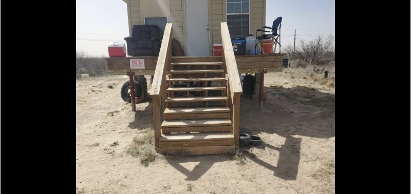

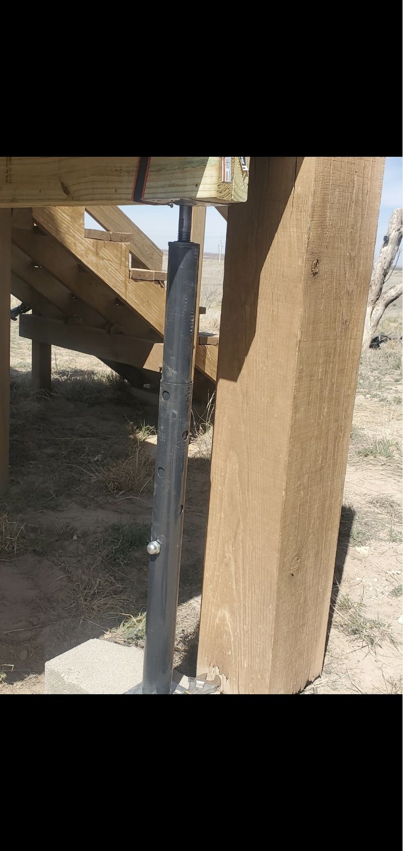

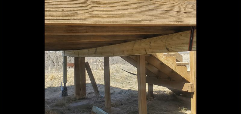

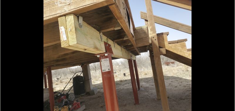

More pictures.

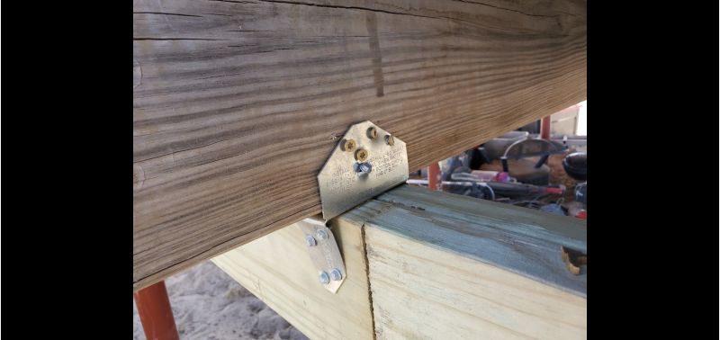

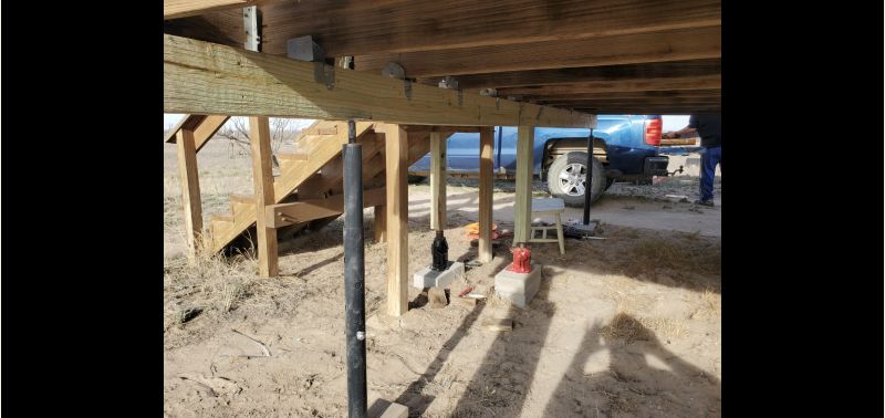

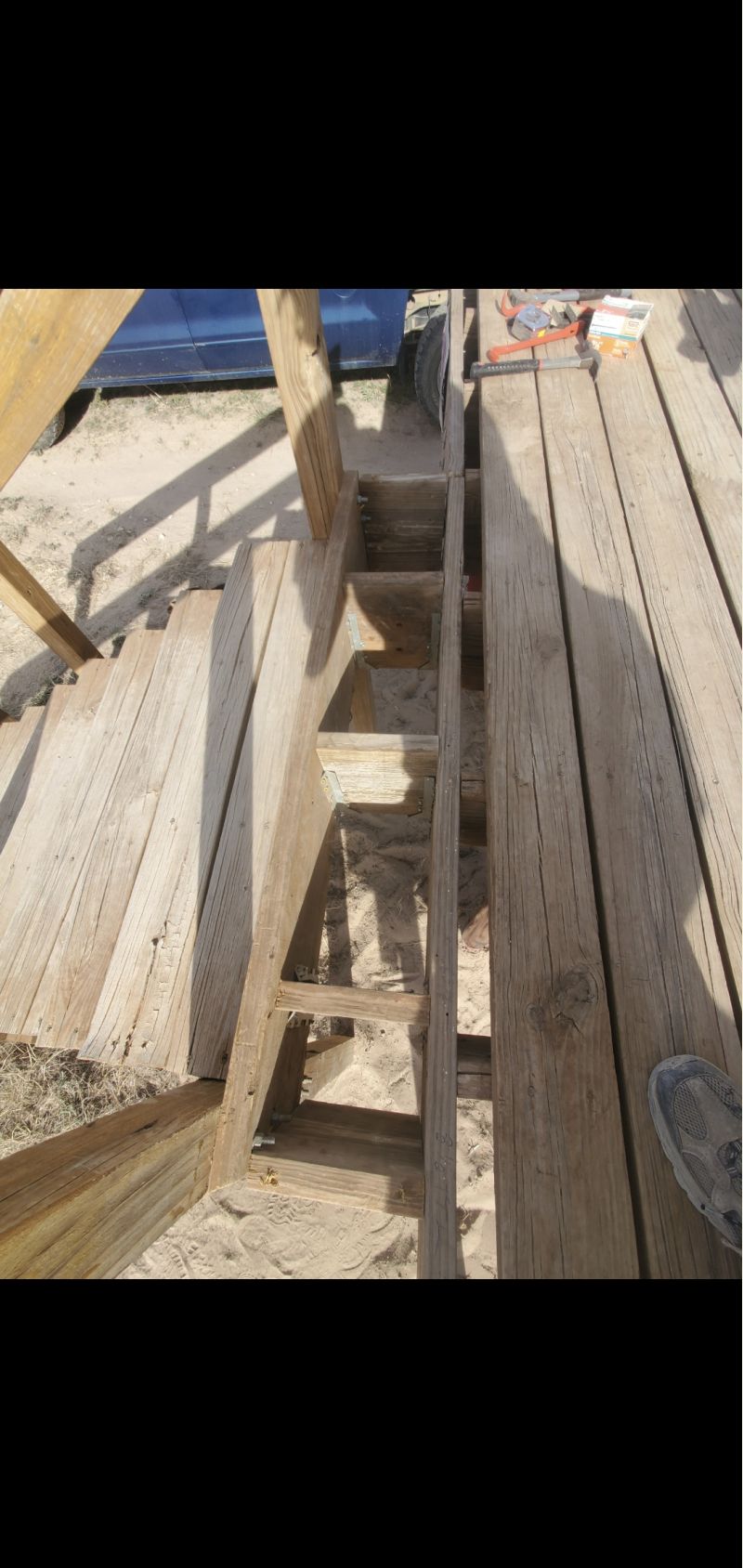

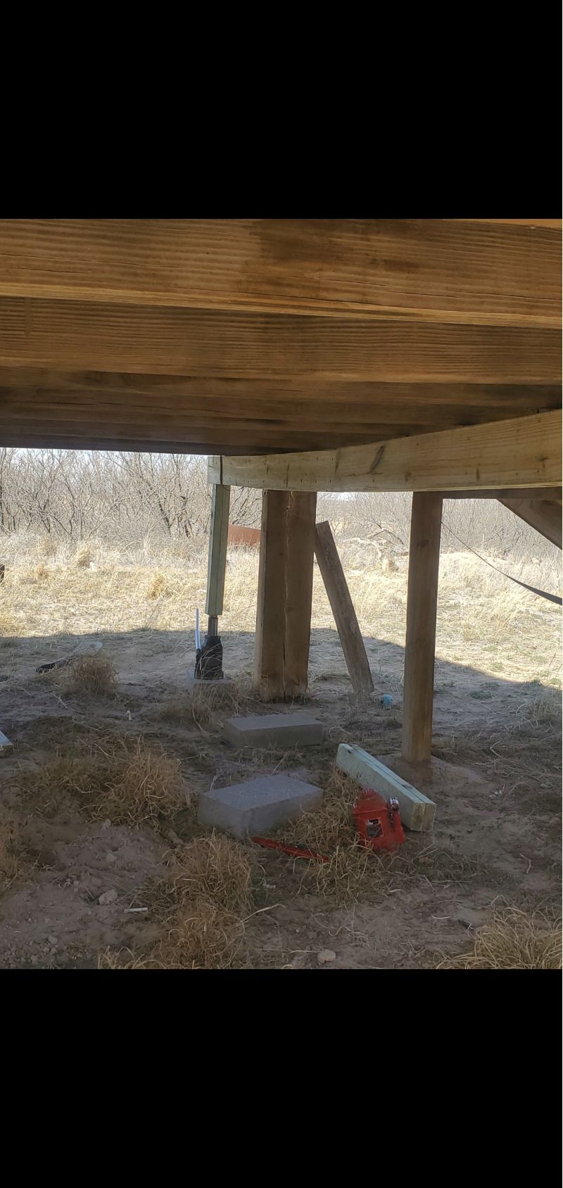

More pictures.

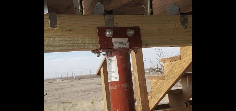

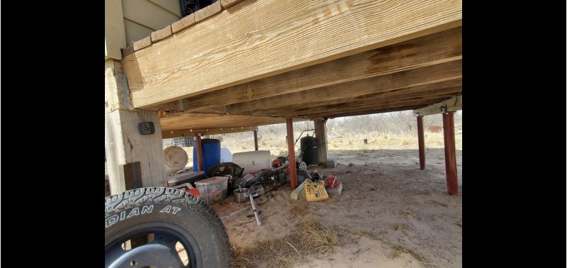

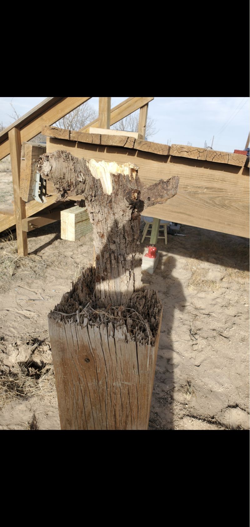

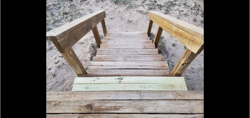

More pictures.

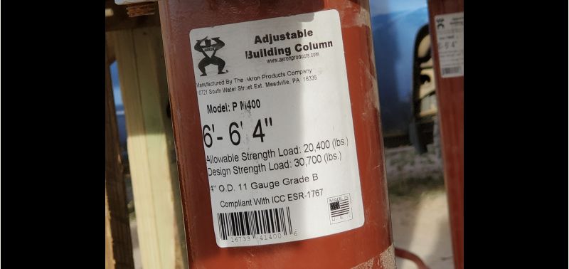

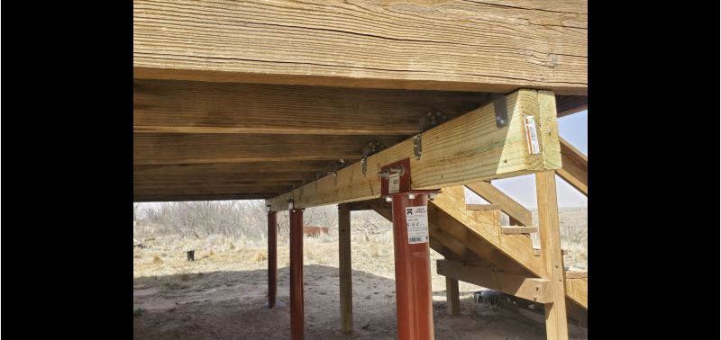

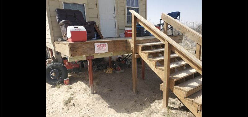

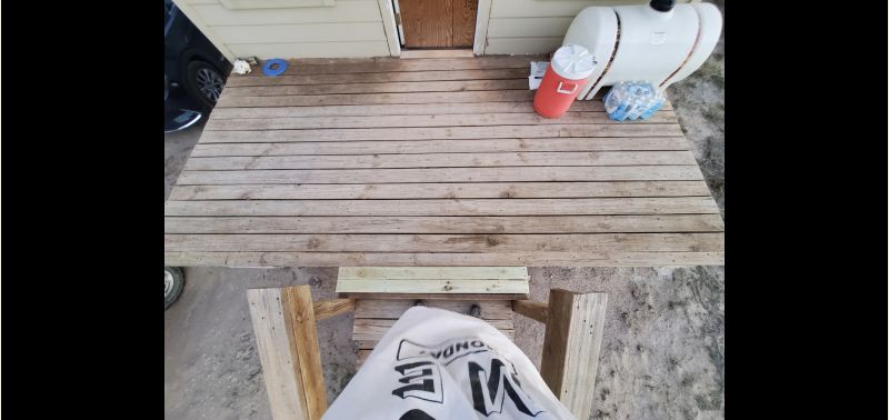

More pictures.

Looks like you have got ahold of it now
Good save

Looks great.
How are the stairs holding up?
ghamilton
# Posted: 3 Apr 2023 01:15pm
Thanks. The stairs are holding up really well. I was worried that when I disconnected them from the old front beam that they might fall down or be too unstable to use till finished the work. They were very stable though when disconnected. I took an 8' ladder to get in and out of the cabin for a couple of days, but never had to use it. The stairs have six 4x4's sunk in concrete about 2-2.5' deep. They are pressure treated pine also, which makes a huge difference.
