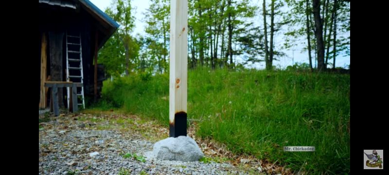

# Posted: 16 Jan 2023 10:34am
HAH! After unbelievable searching, I found an example. This guy goes to greater lengths than I plan to, but his work is great and the idea is the same. See the pic. The entire video is good, if a little tedious. Skip to the part he starts selecting rocks. I think he's answered all my questions.
https://youtu.be/YBhgge17vw4
