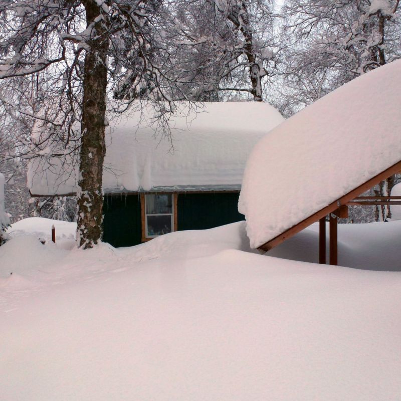

I have 4x4 posts holding up my 12x16 cabin. Longest ones are about 3', shortest about 1'. We get some significant snow loads - over 80 psf some years.
That said, a 6x6 notched for the beam to sit in and get bolted to the 6x6 is a great way to go.

One of those pyramid shaped deck blocks with one of those adjustable brackets that fits into the hole in the deck block.
On the top they are through bolted to the longitudinal beams with 45* 2x4 braces on the longer posts.
I keep meaning to take a few photos of the foundation since the topic comes up so often but never seem to remember when out there. I do have a photo of the snow load though.

# Posted: 1 Feb 2023 08:22pm
What your describing wouldnt be my first choice for a foundation with the snow load I see in the pic.
I understand why you would say that, but there were a number of factors at play at the time and, it seems to be working.
