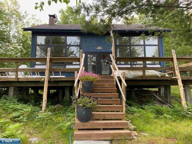

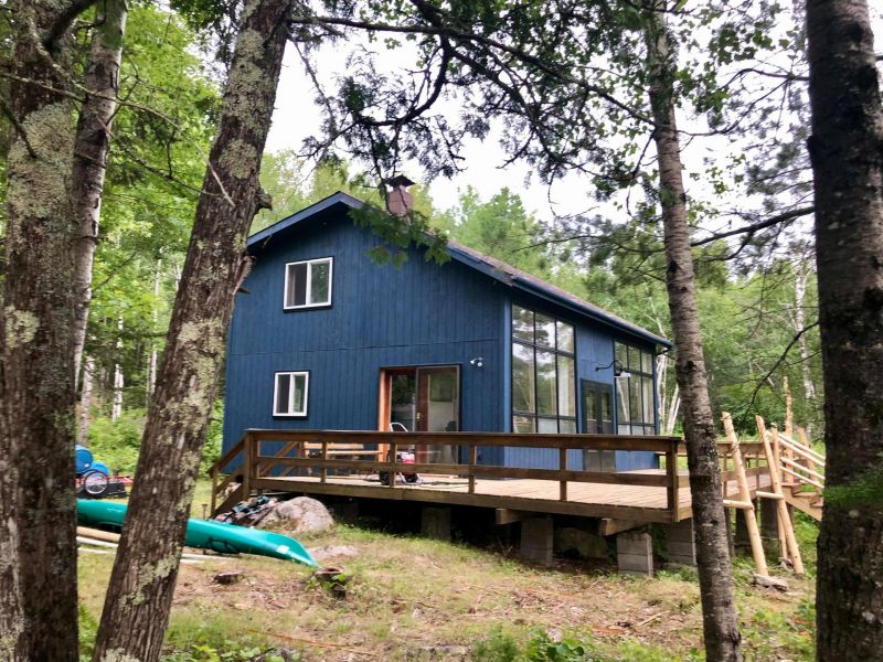

We are shopping for a cabin and found the place in the attached images. It seems like this method of foundation is common in the area but I have no experience with it. My level of construction experience would be best described as somewhat handy homeowner of 2+ decades.
If I were to evaluate the property in these pictures, what should I be looking for to eval the foundation? Obviously I am looking for signs of movement, that everything is plumb, level, and without signs of movement like cracks etc. I assume I should look for signs of deterioration on the blocks. How do I tell whether they're grounded on bedrock? It's winter here and ground will be frozen. Any advise much appreciated.
Base on the images, what other structural or non-structural items would you be reviewing to determine if this cabin is worthy? It has electric and I have enough familiarity to give a rough eval of it. Plumbing is mostly non-existent though there is a non-functioning lake draw system. I will look for signs of water intrusion or rot.

# Posted: 31 Jan 2023 10:05pm
Your pictures do not show much of what the underneath side of the cabin is like. Cross breaking or other stabilizing features. With all those windows? If they have been there awhile? You might think it is stable? Doors? Close easy? Windows slide open shut easy? Any drywall cracks or patches! Wish you the best. Looks like a nice place
# Posted: 1 Feb 2023 08:22am
From what I see it looks prett bad. Crooked piers and some type of make shift ange beams attempting to keep things from moving?
Everything is repairable bit for a price and that price and sweat equity should be reflected in the sale price.
rpe
# Posted: 1 Feb 2023 10:52am
As Brettny says, there are signs of movement in these not-so-close pics. The close-ups will be probably be worse. The main structure is also pretty tight to the ground, making it very hard to fix properly if/when foundation work is required.
# Posted: 1 Feb 2023 10:53am
That is a large and heavy structure and built on a slope. At least you can, or get someone, to crawl under and do a comprehensive inspection. Take pics! Imo, that is the kind of place that should have a real poured foundation beneath. Price that out to negotiate on?
# Posted: 1 Feb 2023 04:15pm
Those logs leaning into the front of the porch are huge red flags. Things are moving down hill and those are a pretty poor cure. Unless it is super cheap, and you are up to a challenge, I'd walk away.

I was thinking that the logs leaning against the front deck may be stabilizing a wobbly rail, but you all may be right that they are a sign of larger issues.

Going off what you have presented here just my opinion of it. It shows signs of racking downward of slope. Aside from the leaning piers under the deck area, A closer look at that side pic shows the siding is bulging outward and maybe its just the photo but my eye catchs the corners not completely plumb and straight.
as others have said a VERY close inspection is needed before making a commitment.
# Posted: 1 Feb 2023 07:08pm
Some times it's cheaper and easier starting with raw land. You may think it just needs a foundation (a huge job) but I bet when you look further it has many other issues.
For instance I see some facia pieces missing on the gabel end and one piece looks rotted. Also the front girder( the horizontal beam) across the deck is tilted prety far. It all still looks attached so I would suspect that cabin/foundation moved 2-4in down hill. The new stairs and railing could be more proof of this.
From the poor pics this place looks prety well deglected but doctored up a bit.

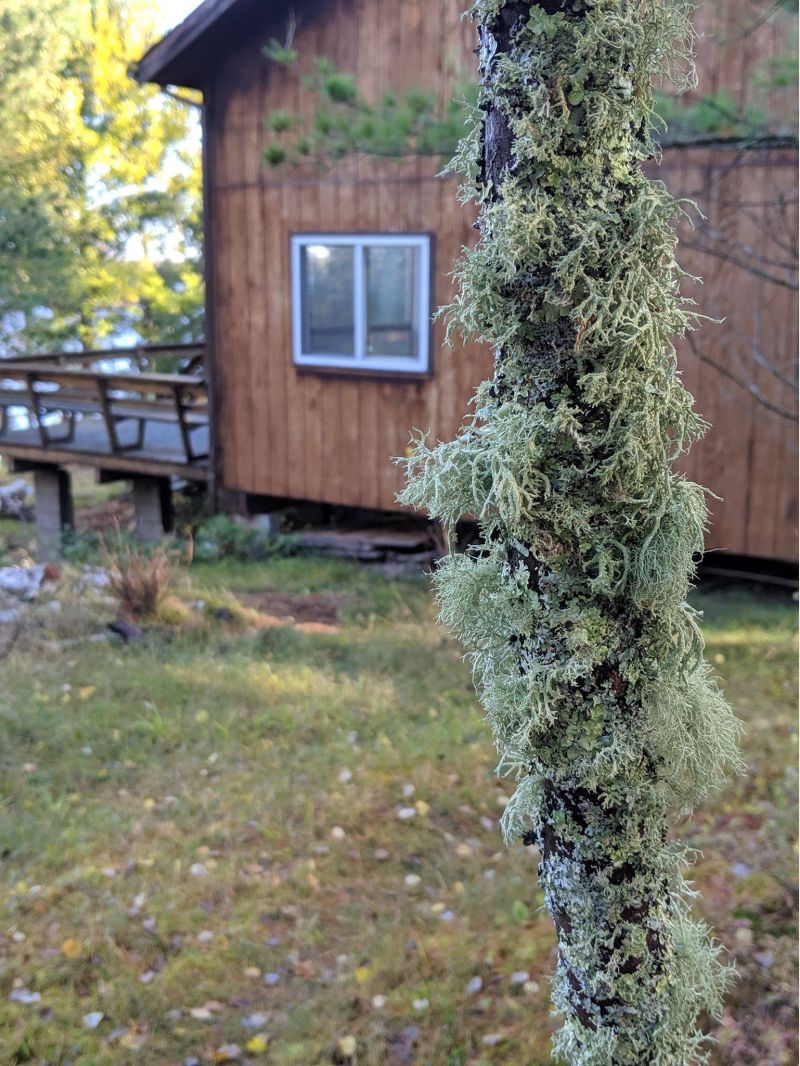

# Posted: 4 Feb 2023 03:16pm
Solid close up of that spruce in the third pic lol

DarrenE, have you been able to look at it since your post? If so, what are your thoughts? Any issues come up that couldn't be seen in the pictures? As others have already stated, that foundation is iffy. A structure that size shouldn't have been built on a block pier foundation. But, they can also be beefed up and re-leved with relative ease. Do the doors and windows open and close ok? Also, I think those poles on the porch might've been put there to serve as a type of guardrail to prevent a motor vehicle from driving into or under the porch, which could be easy to do there if it's dark outside.
