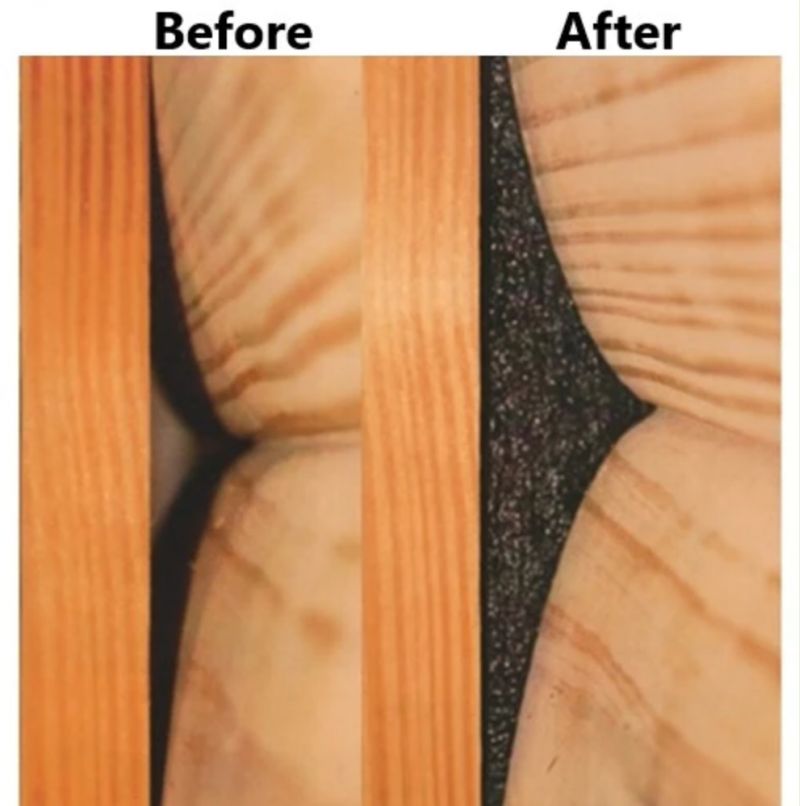

# Posted: 6 Feb 2023 08:34pm
I had not thought that far ahead (my logs are square), but possibly either use the kerf of a circular saw to cut a square to set it into (like some of the log home builders do for window flashing), or build a bit of a wooden box, use backer foam (like in this pic) and chinking "under it" and have the thimble rest in/on that.
