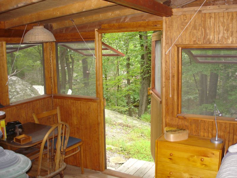

Thanks for all the info guys...but does anyone know an idea of what finish the walls have in the picture I attached?

It is really impossible to tell from a pic.
The light, the aging, the way diff eyes perceive color, etc.....
Minwax, as an example, has a plethora of stain finishes and a color chart that you can take to compare the chart 'chips' with whachagot. Even then, ime, they dont match; could be my perception? But it is the best ya can do to try a match in an expedient way.

As gcrank1 said it's hard to tell from a picture but from the color and the luster I'm going to guess several coats of clear shellac.

To me, the wood in the picture does not appear to be stained. I am leaning in the direction of thinking it may have been a water-based clear coat rather than oil-based. Just a guess, a feeling.

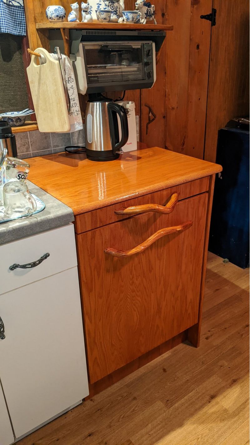

But for some things, poly really makes sense. This is our dishwasher installation, oak plywood and mountain laurel with 3 coats of Varathane stain-poly, and 3 more coats of clear Varathane on the countertop. Beyond is the shiplap pine bathroom door and more of the beadboard, both with the exterior stain.
