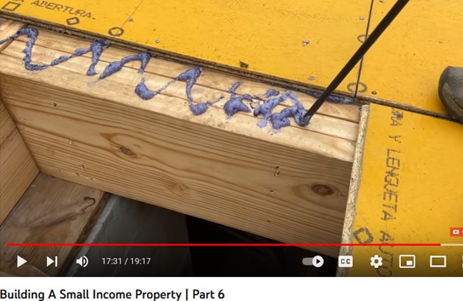

# Posted: 12 Feb 2023 11:21pm
Measure twice, cut once planning we have all heard.
Measuring before installation may be a good idea.
I am surprised they don't use 4' 1/2 x 8' 1/2 before cutting the T&G.
This is a pic from Perkins Builder Brothers on youtube installing Advantech subflooring.
I guess the factory starts with 4x8 then cuts the T&G.
RM, I would add blocking on the inside perimeter and the strip of plywood so the wall rest on a firm structure. .
