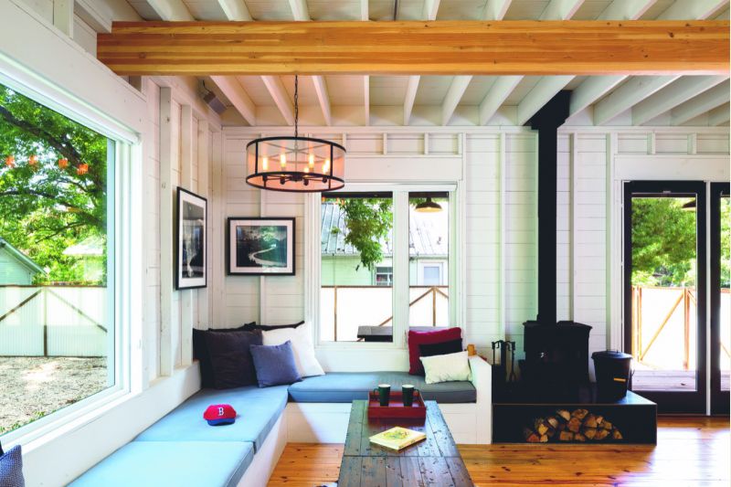

Here's a picture of the inside of the house in Austin, showing the stud bays.
Perfect Wall Interior

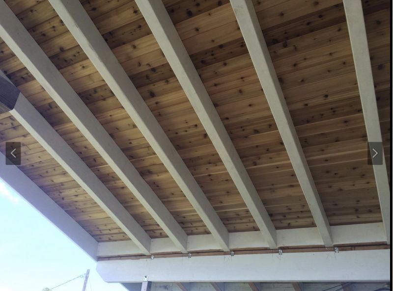

Thanks for the validation! I'm attaching a photo from a different build that shows exposed ceiling planks, with insulation on the exterior of the roof. I love the look of the cedar planks (pine?) and the contrast with the white rafters. I might try to recreate this look by using 4x6 rafters. It would be more expensive but I think I could space them 32 inches on center in which case I would only need 6 of them on a 16 foot building. (It will have a shed / single slope roof.). Any concerns there? I'll double check the structural questions with someone knowledgeable before I finalize a plan.
Not having to do any work to finish the ceiling and interior walls seems almost too good to be true. Having the open stud bays will also make it super easy to install shelves, hooks, etc. For weekend bunkie type projects it makes me wonder why most people don't go this route. Maybe most people don't like the look. Or maybe it's more common than I realize. Or maybe it's a cost issue. This is such a small building that's not a factor for me.
One question I had is whether I'll have moisture / vapor problems. I haven't thought through where moisture would condensate on really cold days and really hot days on an under-insulated building. But there won't be a ton of moisture aside from what comes from 1-2 people. (No shower, no heavy cooking aside from a coffee pot and a hot plate.) I don't think it should be an issue in part because the exposed stud bays and ceiling should allow moisture to dry to the inside if moisture did build up with people inside for a couple of days. Anyone have thoughts about that?
To insulate the floor my plan was to drop rigid foam between the joists, resting on furring strips, with some kind of hardware cloth underneath for critter insurance. (It will be built on piers or maybe skids.) I haven't heard of people just laying rigid foam right over the joists then putting subfloor on top of the foam. The foam is strong enough to handle that?
