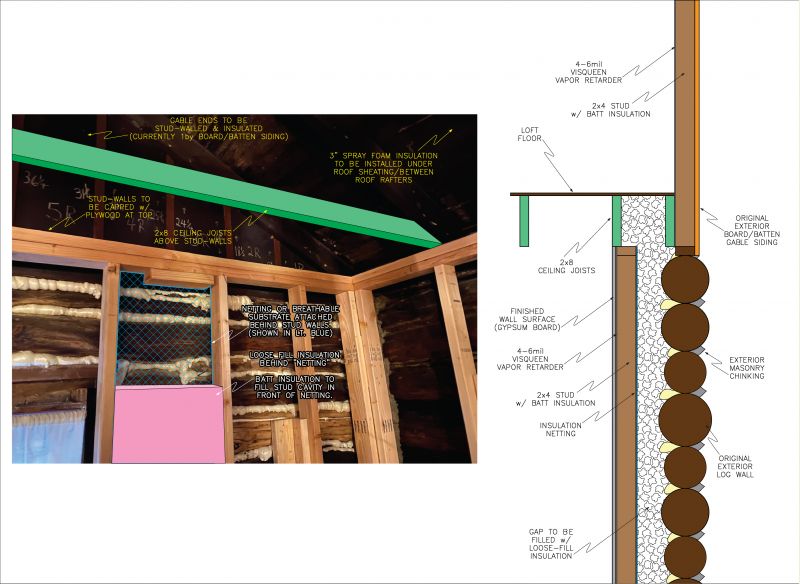

In your fist post you said you were going to spray foam the rafters, why not spray foam the walls also. If that does not fit your budget I can understand that because the foam is expensive. It sounds like this is a perfect job to use dense packed cellulose. Northrick suggested that you blow cellulose down the wall from the top opening. I agree with the use of cellulose , but I don't suggest you just blow it down the wall. The air from the blower cant get out of the cavity without coming back to the top and it will keep fluffing the insulation up, when the cavity is full it will look really good but after a year it will settle down about 12 to 15 inches. I would buy the netting and fasten it to the studs, . Get a blower from where you buy your cellulose. These will not be as strong as one that professionals use but it will work just fine, just a little slower. Also I would run the 2x4 up to the roof and fasten them to the rafters. Then run the netting up the wall to the roof and up the rafters to the peak and pack the whole thing with cellulose. You might have to work around some cross ties in the attic area I don't know how your cabin is built. Dense packed cellulose is the next best insulation, behind spray foam. This is how I insulated my cabin 10 years ago and I haven't had any problems yet.I have never worked with rockwool insulation, so i don't know how well it works. I will never use fiberglass again they should outlaw that stuff, it is junk in my opinion. Don't be afraid to try this its not that hard to do and you will love the results. If you need any more info I will be glad to help out. I would not suggest this method if I hadn't done it myself, and I am confident that you will like the results. Good Luck with your project.
ThisOldCabinNJ
# Posted: 28 Feb 2023 08:22am
Hmmm, blown cellulose or any blown in insulation? Not a bad idea. It would certainly fill the uneven voids nicely and quickly. I don't know why i didn't think of that. I could even net behind the studs, "blow" in the loose fill, then install batts into the stud cavities.
Just curious: what's so bad about fiberglass insulation that it should be illegal? Other than you itch for the next 6 months or if it gets wet, it becomes trash...LOL Over the years i've become a big fan of the rockwool. Its just lava rock spun into a fiber similar in process to fiberglass. The batts are dense and cut super easily with a bread knife. I wonder if they make loose fill rockwool? They claim rockwool can be soaking wet and still remain as good as the day it was installed AFTER it dries back out. Fiberglass won't do that.
Spray foam is quite pricey HOWEVER after I considered the "cost" of my labor, cost of having to get scaffold, cost of time to install insulation into the roof and time (i work alone and slowly because i'm super anal-retentive) all equaled more than the metaphorical 10 minutes it would take a professional guy and a tank truck to come spray foam the roof. LOL.
I considered spray foaming behind the stud walls but what stopped me was the fact that I didn't want to destroy the interior log face in the event someone in the future wanted to remove the stud walls and refurbish/expose the logs. I'm just a steward of this log building until the next owner takes over. That said, I still do what I want, I just try to consider how my actions may affect the future. Also, if I have to replace a log, i feel the foam will make a mess for me to try and fix if its all foamed together?
Anyhoo, I'm going to look into said loose fill insulation. Even if I only loose fill behind the stud wall then use batt insulation or something.

# Posted: 3 Mar 2023 11:00am
Here's maybe/hopefully a better representation of what I plan to do....if anyone is interested in seeing a visual.
ThisOldCabinNJ
# Posted: 3 Mar 2023 11:01am - Edited by: ThisOldCabinNJ
sorry for the poor quality. The diagram was created as a hi-resolution file that the site trashed.
