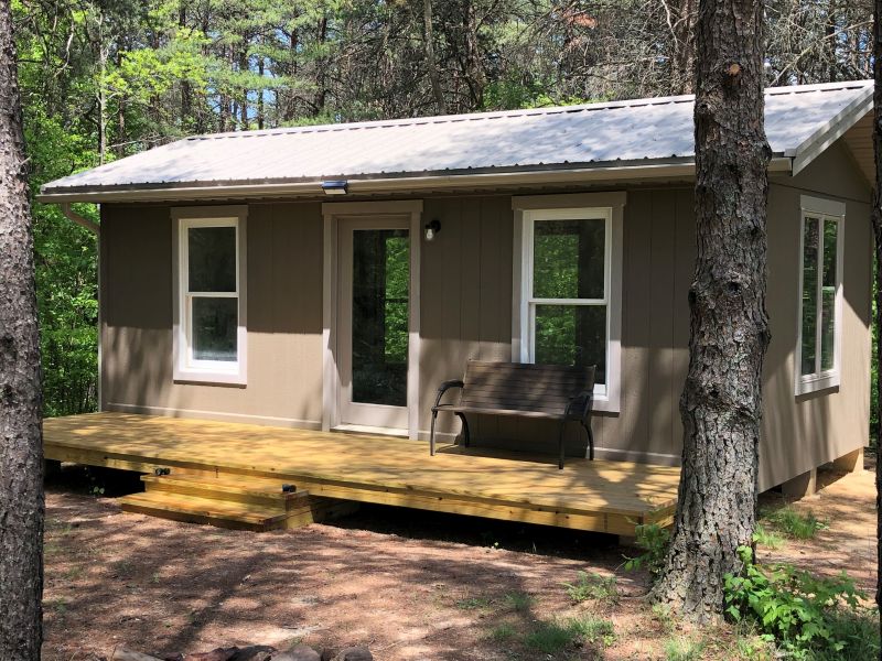

There are two choices concerning the siding. One, it's available in 9 or 10 ft, you just have to order it. I ordered 9'. However, after I finished the structure, without the siding, I realized my soffit came down far enough (4/12 pitch with 18" overhang) due to the rafter tails extending down far enough and then the return of the soffit. I really only needed 8' and this went below the rim joist about a 1/2 inch (creating a drip edge) covering everything. So, see if that might be your case too.
As for the porch, I think you will find it will depend on the wall height. You will most likely have to tie into the roof and come out if you want it to have a decent pitch. Otherwise, if your porch is low enough and you don't mind a step up into the cabin, you can come off the end of the rafters/fascia board with a light weight framing (like 2x4). Others probably know better, since I too wanted to do this, but chose not to in order to finish up my project as fast as I could. I've been thinking about incorporating it into the structure now, though. But, in my case, I set the deck about 4 inches below my door threshold, as you can see in my pic.
