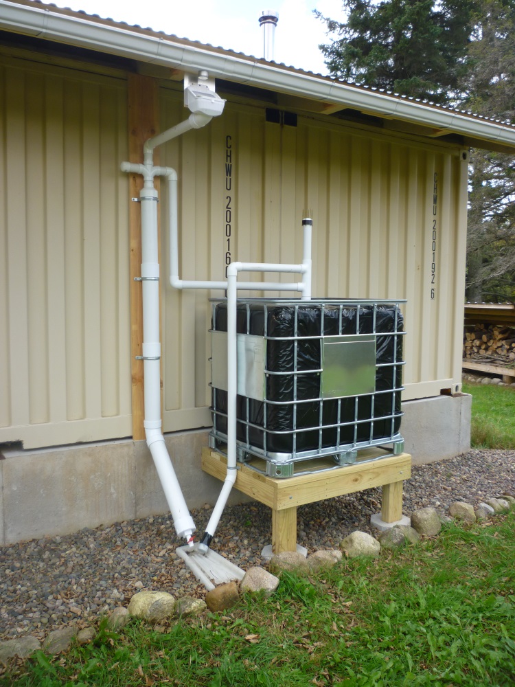

# Posted: 22 Mar 2023 10:10pm - Edited by: Steve961
I also have a cabin in North Central Wisconsin with a metal roof, rain gutters, and a water collection cistern. I installed the gutters about 8 years ago and haven't had any problems with snow damage. I followed the following guidance and it seems to have worked so far.

# Posted: 25 Mar 2023 05:01pm
If anyone is interested, here's a picture of my gutters and cistern.

We have a 12:12 metal roof and gutters mounted as per Steve961's diagrams, just below the projected roof line. They survived one winter so far. We don't get more than a few inches of accumulation before the snow sluffs off, and when it does the slide goes over the gutter.
# Posted: 26 Mar 2023 09:09am
That is impressive, Steve
