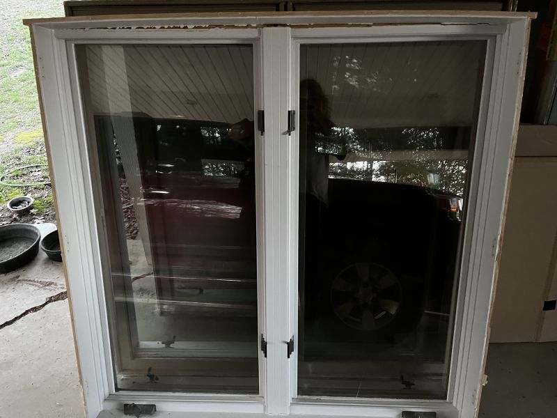

I got a good deal on four big, recycled casement windows for my 12x16. Three that are 5x5 and one that is 2.5x5. I'm excited about them, but there's just one issue: I'm not sure how to put them in.
I've never done it before, but I think get the general idea of framing out and installing a window. Frame the opening a little bit wide, install the window centered in the gap with shims around each side, screw through the sides of the window frame into the trimmers, and then install trim to cover up the gap both on the inside and the outside of the window. First question: is this at least roughly the right idea? Any good resources on this would be much appreciated.

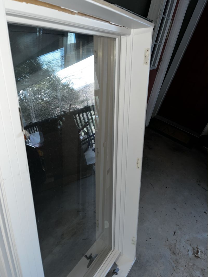

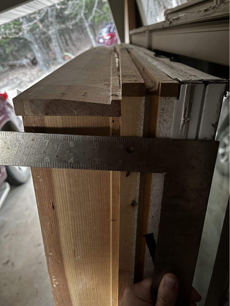

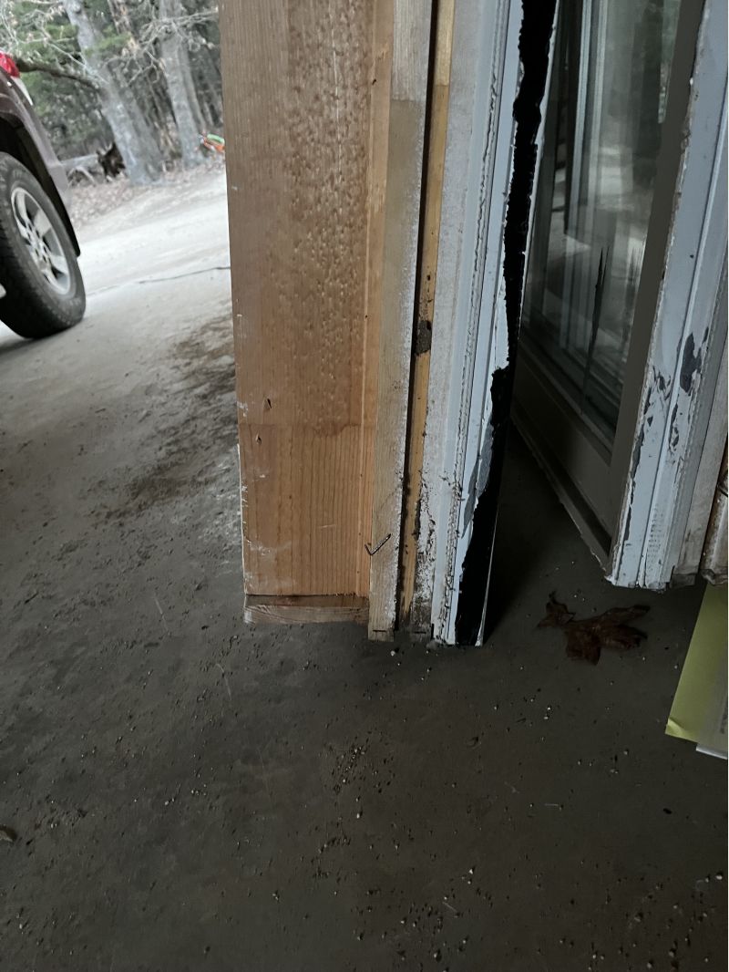

The second question is for these particular windows in particular. I'm not sure which pieces should actually go where? I'll attach pictures below, but the setup of the window is that there is a two inch section in which the window actually rests - maybe this would be the sash? From the weather stripping and the remnants of what I assume was a nailing flange, this seems to me like the part that previously would've been outside. Next, there is another 2" section the same size as the first section that is a wooden box. This has grooves running up the sides, and the crank for the window is located on the edge of this section, facing out. Finally, there is another box, 4" in width, that is slightly smaller than the overall window. I'm not sure what is going on with this part. It seems like it could just be pulled off, and it's slightly more damaged than the rest of the window, so it seems like the way to go? Especially because I am planning on using 2x4 walls, so the whole thing is way too wide for what I'm currently planning.

# Posted: 6 Apr 2023 10:48am
To awnser your thickness question.. it looks like those windows still have a jam extension on them. That's the white/interior part. The actual window looks to be about only 4in thick. How you flash really depends on the siding not the trim. Try to remember that things like cawlk are not ment to be a primary water sealer.

Quoting: Brettny
This is kind of what I was thinking. So it would be alright to tear those off, and then I would be able to set the windows in my 2x4 walls? With a little hanging on the outside, where I would install flashing and trim? I’m planning on using 3/8” T1-11 over 7/16” OSB sheathing - any flashing advice for this setup?

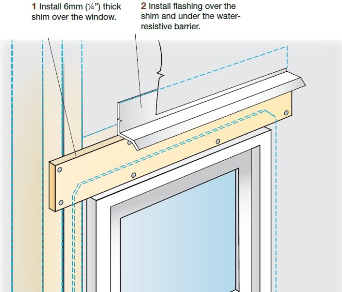

# Posted: 7 Apr 2023 01:22pm
If you're anywhere remotely wet take the extra step to put metal flashing over the top of each window (inside the trim and inside the vapor barrier) like this:
-- Bass

# Posted: 7 Apr 2023 05:10pm
Think Id use a 'cap piece' like in that link by OGI above or an oversize? Z flashing topside of the window, on the sheathing, weathershield overlap, and finish with the T-111. No need to caulk the gaps, water would run off.
