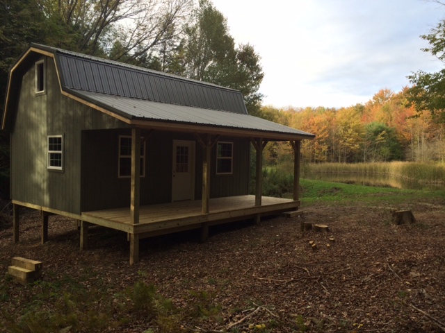

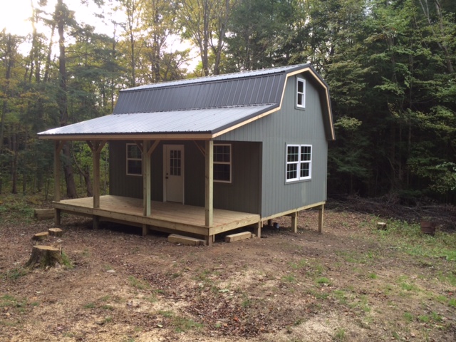

The siding is the pre primed/coated t1-11 type. Yes the soffits are wood. It has actually held up really well but I do need some aluminum fascia. the cabin is actually built by a Mennonite. He used dimensional lumber and modern materials etc. He also had an F250. So not really Amish built.
# Posted: 20 May 2023 08:56am
Pretty nice , well worth tuning up a bit. Wish my 'hack built' 16x24 was 1/2 as good.
