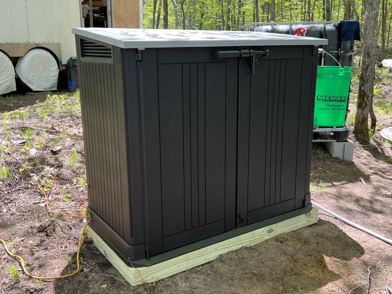

Anyone ever use one of those small resin/plastic storage units (roughly 4'x2'x3' tall flip top) as a pump house? Was thinking that would be quick and easy and being all plastic i wouldn't have to worry if there were any leaks.
My original thought was to either do a slab or gravel base and then stick frame something over it, but considering other options now.

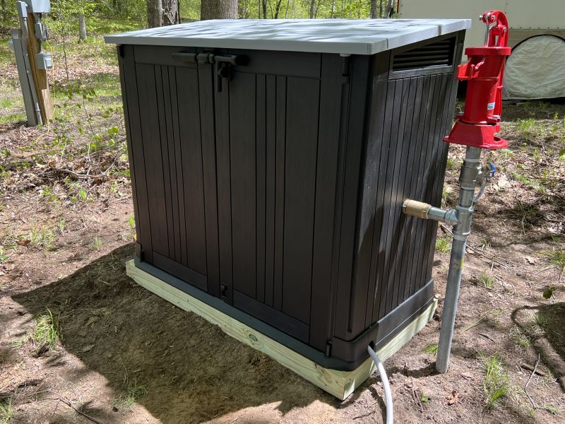

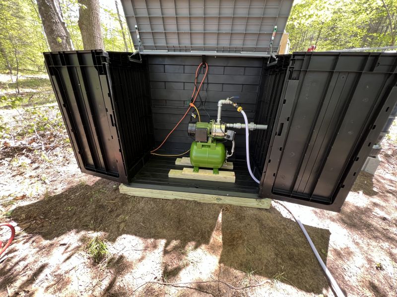

Looks like i never followed up with what i ended up doing for this project. Ordered a resin shelter kit from Amazon and installed it only a pressure treated timber frame to get it level and off the ground a bit. Works well for eliminating the eyesore of the pump, protects the pump and helps cut the sound down a bit for when the pump runs.

Looks nice and clean...

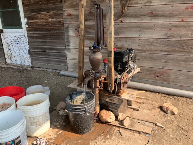

At the ranch I pounded in a sand point and installed a gas engine on it with homemade pitman arms that operate the gear box to draw water up. It works great there but I don't use the water in the cabin it is for water garden, trees and livestock.
Here is a picture of the one installed at the ranch.
