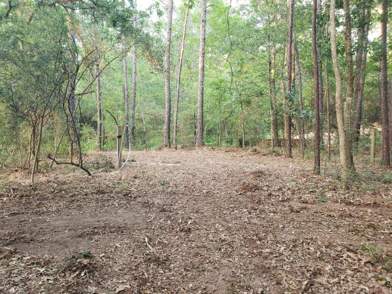

Hi, newcomer here. I am just getting started on two 16x24 cabins. I have a few basic questions about the foundation.
Around here (Houston area), everyone seems to use concrete blocks to keep their sheds and small buildings off the ground. We don't really have a frost line. But I want to get the floor joists about 3 feet off the ground since there is a creek nearby which may overflow. Is there a way to stack a bunch of blocks together that would work? What other inexpensive options are there?
If I do go with blocks, do I need gravel underneath? Is the purpose for frost heaving, drainage, or something else?

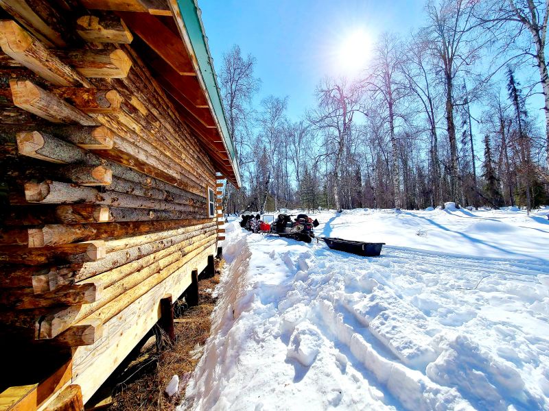

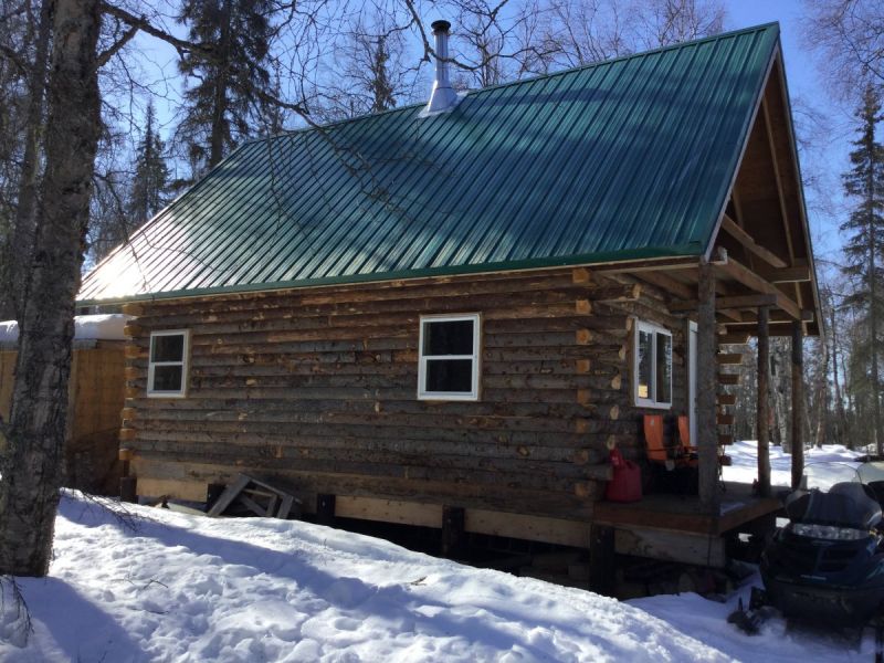

I have cedar posts under our 16x24 log cabin that is 3' off the ground and no problems. Has gone through a 7.2 earthquake with no issues. And gets loaded up with several feet of snow.
The cedar poles were used utility poles. And it is doing great. In fact I checked it with a level last time out. I went 4' deep because of our frost.
Put poles in and cut a shoulder out on the top. Bolted a 6x12 beam on that sits solidly in a shoulder cut out.
I was able to dig the holes with a gas power auger. A bit of gravel in the bottom and I used ready mix cement to backfill.
I also went with 10' tall walls so we could have an upstairs. Really nice to have the space
