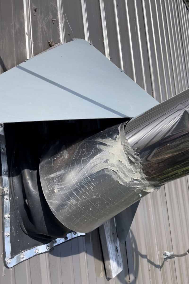

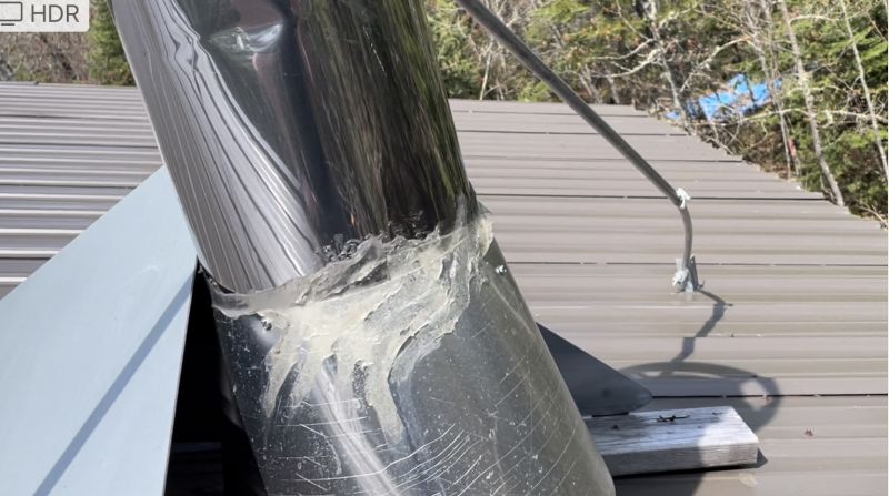

One of the support brackets was ripped right out of the roof...Bracket intact, screws ripped out. Then the support somehow got a big bend in it. The snow splitter on that side of the chimney was also ripped right out. Otherwise completely intact.

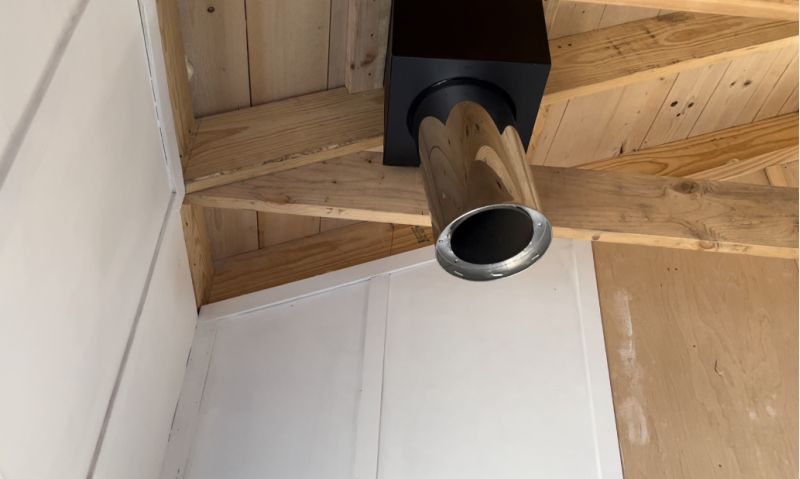

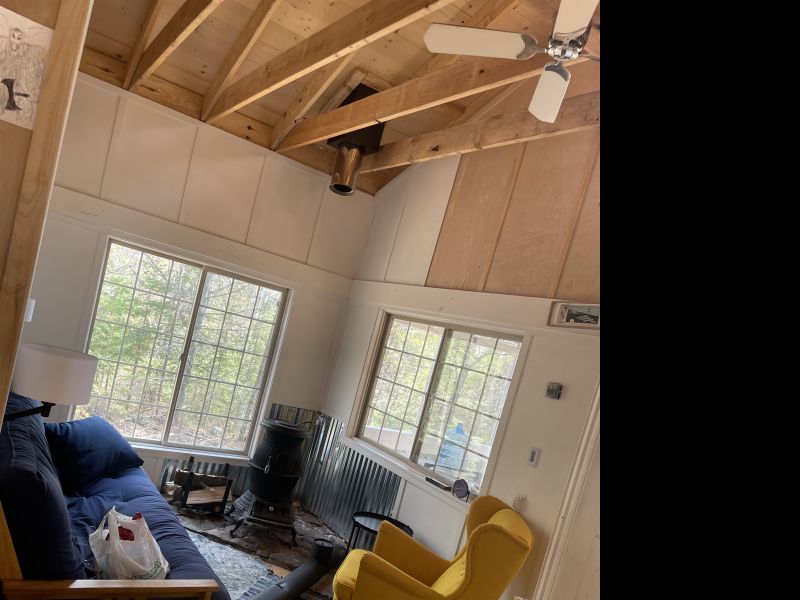

Luckily the chimney is fine… just tilted. Seal is fine as well so thankfully no water intrusion. When the chimney tilted it caused the inside to lever the other way and disconnected the stack inside the cabin. That was laying on the floor but still in good condition.

Went to repair this weekend. Well the “adjustable” legs on the chimney support are frozen up and won’t move. (It is simply two pieces of conduit sliding inside each other with a hose clamp over the end).
I couldn’t adjust it despite hanmering on the ends of the poles. I simply reattached everything and wrapped some wire around the chimney to hold it temporarily.
I need new supports.
I’ve used two of these kits and they’re not great… That and the band contraption they use to secure to the chimney is huge pain as well.
