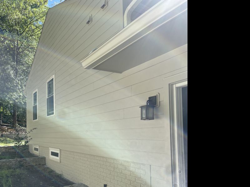

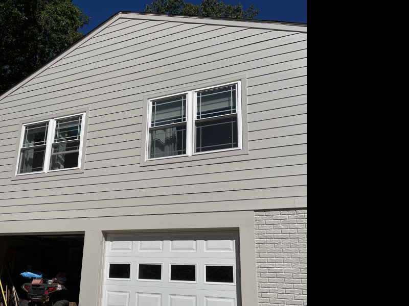

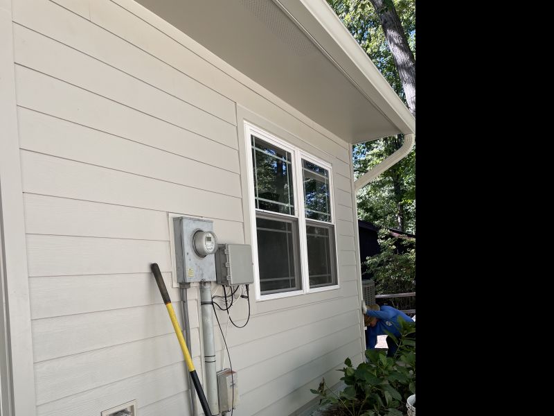

# Posted: 11 Aug 2023 08:00am - Edited by: DaveBell
Driveway full of material. Install starts Monday. I talked to my neighbor who had his vinyl siding replaced (seems like he does it every 10 years) and he said he paid $11K. I am paying $30K for the Hardi board fiber cement because I don't ever want to do it again.
In ten more years he will pay $14K, and and another ten years, $18K, and still have a fire hazard. So cost benefit analysis, we will be at the same cost expenditure in about 14 years. Includes new 6" leaf guard type gutters.
My other neighbor has T-111, on a lot full of monster oak trees. He just repainted it from Forrest Service brown to Forrest Service brown with a little red tint. Looks real good.
So I know you guys think and so do I, that $30K is too much but Hardi has a dealer network you have to go with it you want their product. Very little competition. I did negotiate it down from $34K like everything else they start high and have room to come back a little if they want the work.

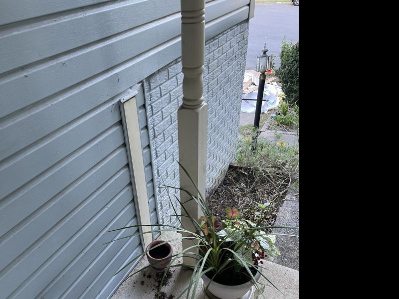

# Posted: 31 Aug 2023 05:00pm
No more Blue house.
